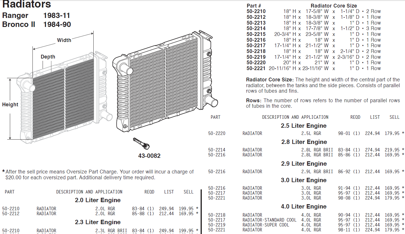

And what 4.0 radiator should i swap in. my old radiators oil cooling tubes leaked in to my water i the past so instead of replacing the radiator i flushed and blocked those ports of, and installed an aux oil radiator, could this be cause for the high temps.

I used a radiator from a 92 explorer with a/c and an auto transmission. You aux trans cooler could raise your temps slightly depending on how much of the radiator it cover and if your fan isn't strong enough.
While lmc is a good place, you can get one much cheaper other places. Spectra part number CU1164 should be good, found it on rockauto for $101 plus shipping. I got mine on eBay for like $85 shipped.
Sent from my SPH-L900 using Tapatalk 2
im just wondering what type i should get so i can buy or pull it used, lmc photo is just a good reference
