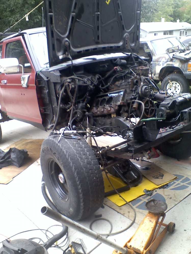

these horns are already there... you just need to make a small diag cut right near the horns and follow it along under the firewall. then tab it in if you want for more support....you can weld nuts to the backside or use clip-nuts.... this is easily done with no welding and a few pieces of metal strap if you want max support. i will take a picture of my bronco setup...it is what you want.
mine on this pickup is fully removed but that is unnessessary with a truck that is not rotten and in need of patching. my trucks are saltbelt to say the least.
i make the radiator stand alone in most situations if allowed. cutting the core open for airflow is my preference if power is the goal. i run the diesel radiator from a g 30 application and it sits where the frame is modified. i do not need the front end on to drive the truck.
just to get an idea of scale....this is a 350 next to a 6.5...
it takes 10 minutes to pull the front end off and you can pull the heads off of a big block no problem....or anything else that needs wrenching....i can totally pull all of the trans bolts...only have to go underneath for torque converter bolts.

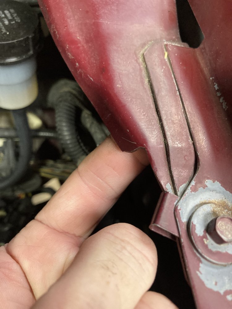

see array of photos (mud free! LOL)
With questions.
Top photo, my finger is IN a hole underside of “horn”, which seems like the hole you may have used after drilling the inner fender panel.
Next photo:
Finger pointing along the seam, wondering under the outer fender skin, are there spot welds to drill on the top flank?
Next photo:
Simply to illustrate what looks like about 6-7 spot welds that will need drilling in the vertical plate of the “horn”.
Last, what do you do with the fold over factory tab at the firewall??
Does it do anything after modification or get in the way??

you leave the horn as is....just seperate the spot welds... unce the fender is off...it should be clear.
