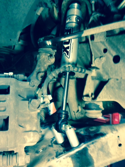

Well the Fox 2.0 ranger front shocks are to short for edge and sport models with T bar suspension since they basically have a 2in lift stock if you cranked the bars another 2in you have a 4in lift! I'm curious did you order f150 front shocks or the fox ranger front shocks? I just went though this there is a fix to make the fox shocks work? I wound up making 2in spacers out of some 1in aluminum bar stock I had in the shop and put them under the bottom mounts with some longer 5/16 bolts and put about a half inch of washers under the top cup washer to lower the top of the shock.... Here's a pic!
The limiting factor on shock length in the T bar suspension is the upper ball joint pull your shock and let the suspension sag it will stop when the upper ball joint binds for max travel on the shock jack it up about a 1/2 in and measure from the top of the lower a arm shock mount to the top shock mount make sure you keep the travel under this or add limit straps to avoid upper ball joint failure!
For the right shocks for a Edge or Sport 2wd models look at the 4wd shocks since the Edge and Sport models come from the factory with turned keys and lift blocks used in the 4wd models!
