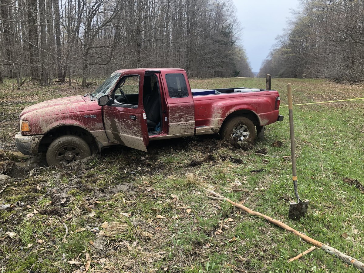

Here are some progress pics form pulling my truck out of the mud. Was sunk up to the frame in boggy mud. My brother and I used a come along, two 30' straps, and a tree to drag it sideways out of the mud. There were no trees in front or behind the truck. We had to dig out the wheels and lift the truck up with a jack multiple times to keep it from digging deeper in the mud.

Roert42 wow what a nightmare. Thanks for all the add'l good info.
What is that pipeline r.o.w. or firebreak or what
