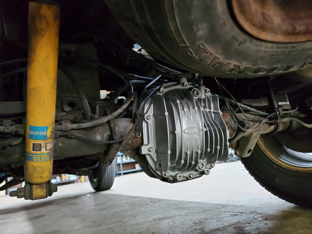

My bad I meant finned alum diff cover
Like this??
