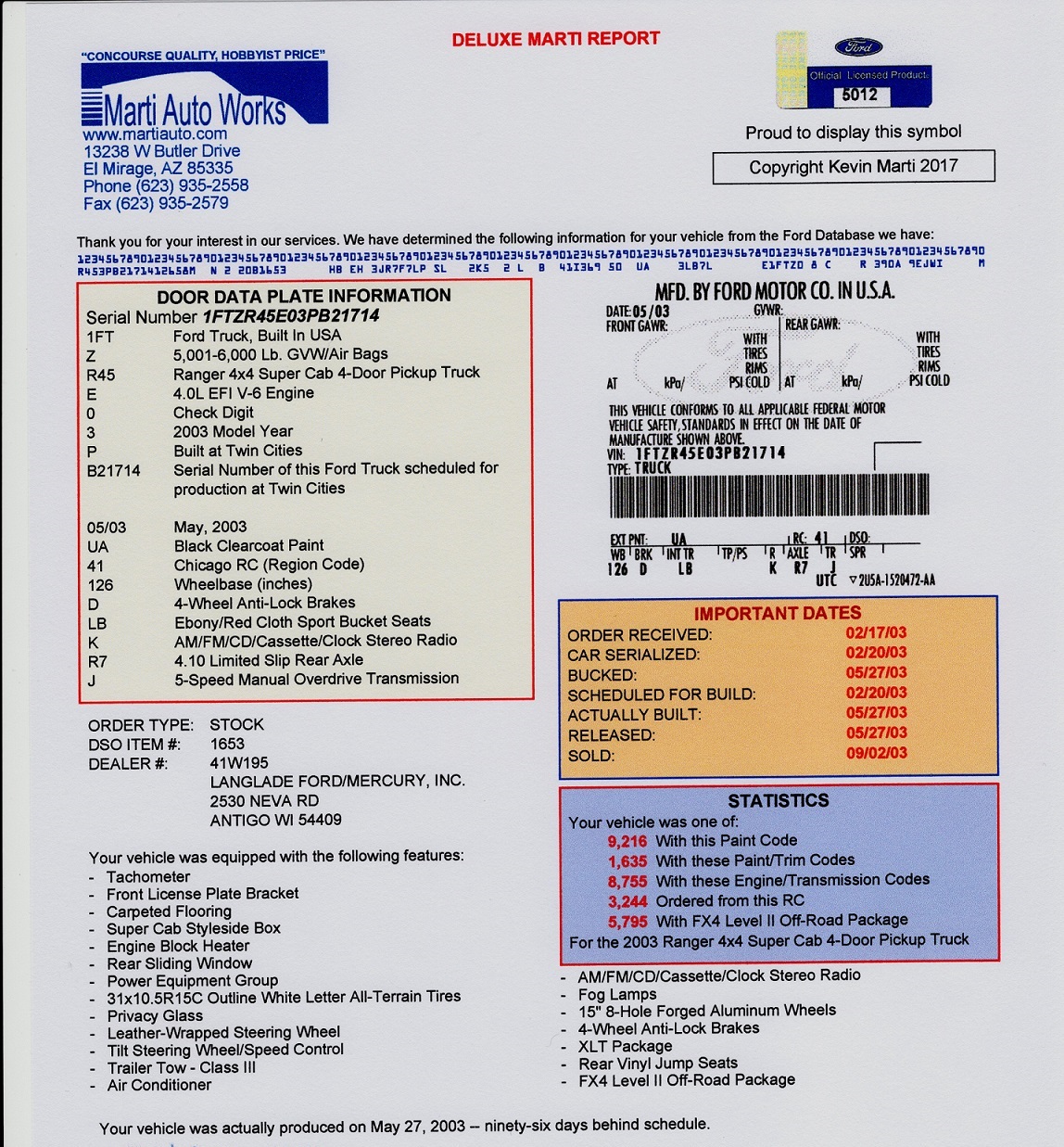

Only way to get a full account of what your Ranger came with is to get a Marti Report on it based on the VIN. They have all the (well most) records from Ford going back to '67'. Got mine for the 2003 FX4 for $40. Lists a lot more than what's in VIN or door data sticker, all the options.

YYYESSS!!!. Thank you Mac. This is what I was looking for. My next step was going to be - Post a pic of my door sticker and let ya'll tell me about my truck:sad:
