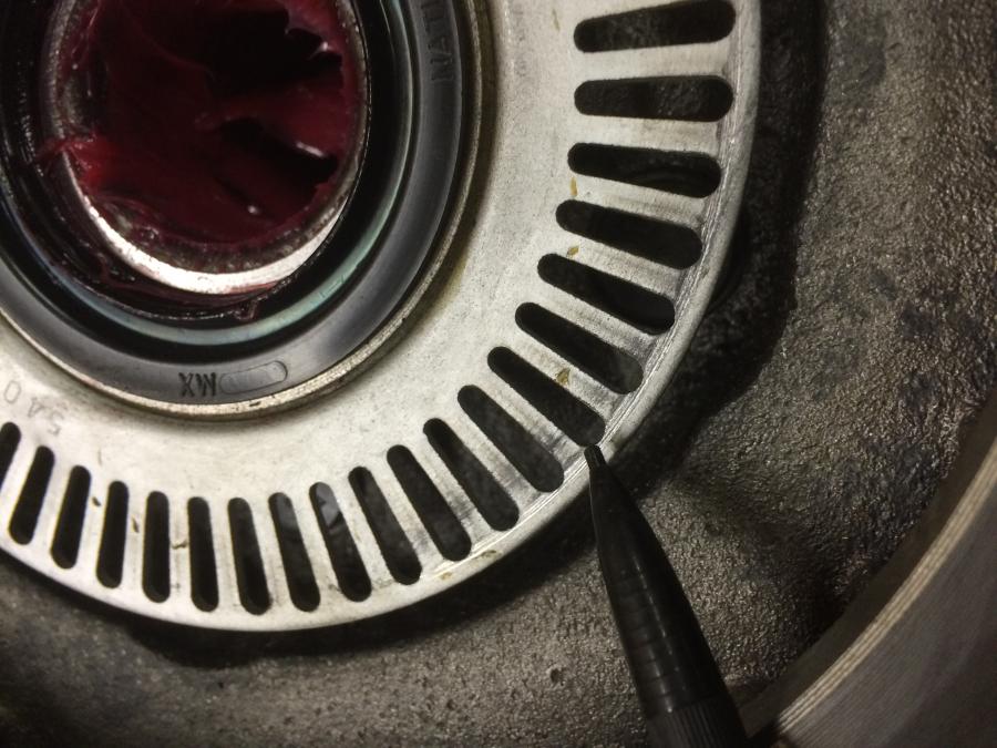

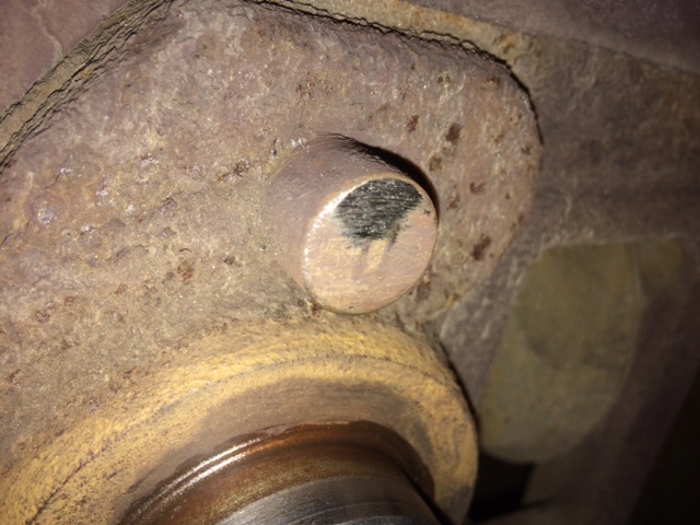

Hey guys,
Tonight I broke the wheels down to the bare rotors in preparation to just remove them completely and return them. Without the calipers, or caliper bracket installed I turned the rotors and felt a drag, and metallic scrape. Nothing visible from the outside, but once I took the rotor completely off, the heatsink thing or whatever that circle piece is attached to the backside of the rotor was rubbing against a small metal lug behind the rotor (see pictures). This was the case on both wheels. I tried playing around with re-torquing the bearings but every time I got things centered and tightened down, the metal part would rub again.
I never really payed any attention to the sound because by the time I spun the rotor around, the wheel was already installed and I figured that sound was just the brake pads against the rotor.
Going to take these back and get a different brand...

Yeah that is your abs sensor and it should not touch the rotor...
AJ
Sent from my Samsung Galaxy Note 4 while sitting in my underwear
You might be able to shim the sensor to back it off some
