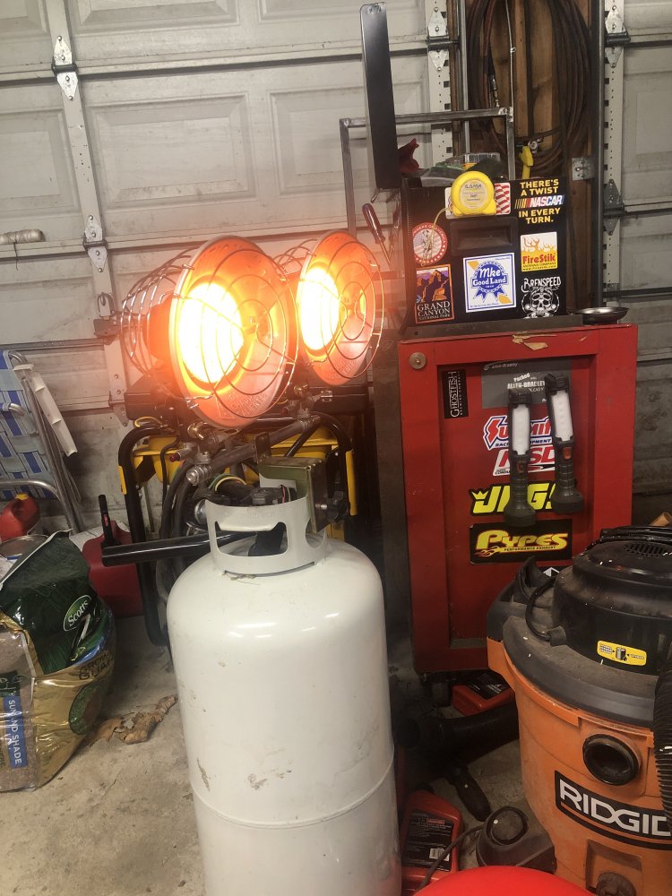

homedepot has one and two head versions of this. Helps keep me from freezing to death in my garage, so I like that part of it. Even used it to heat my house for a while, and I know a couple of guys that use them for job site heaters. Can’t remember the brand.

I have the three head version of that. Be aware that there is a smell associated with them and there may be carbon monoxide concerns as well that you don't have with ventless heaters! But it works damn good, it'll heat my 1200sq/ft shop nicely.
Single head works on a 20lb propane tank really well, three head will freeze up a 20lb tank in cold weather. I run mine off a 50lb tank now and it's much better.

Double head guy will freeze up a 20lbs too if you turn it all the way up and run it for a while. I have mine on a 40lb bottle.
