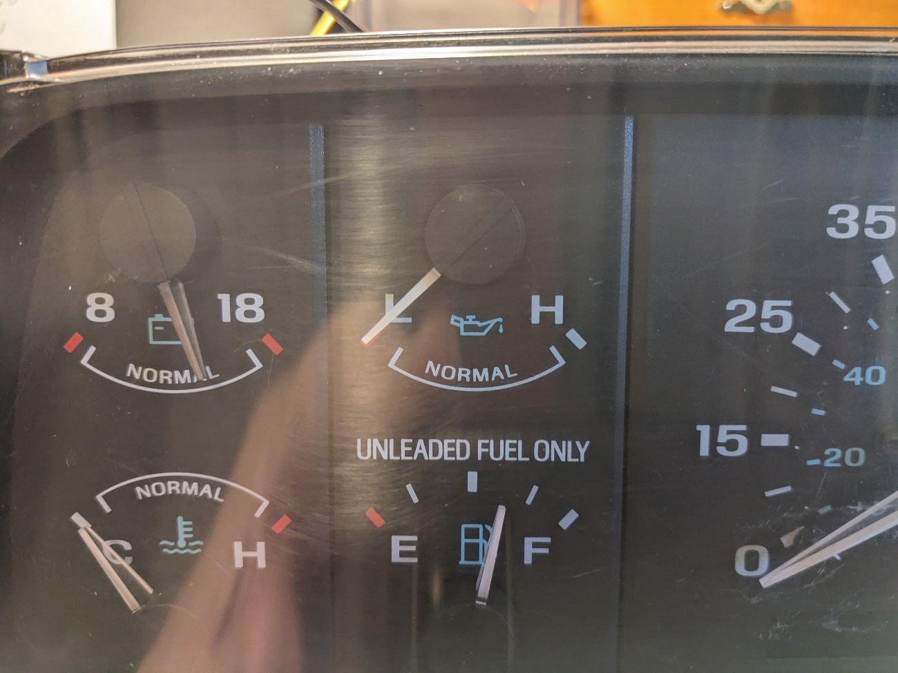

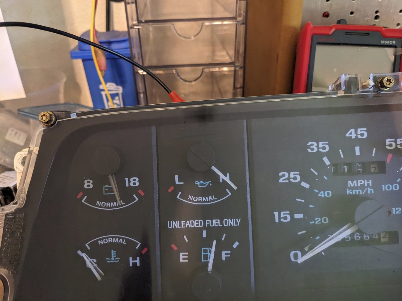

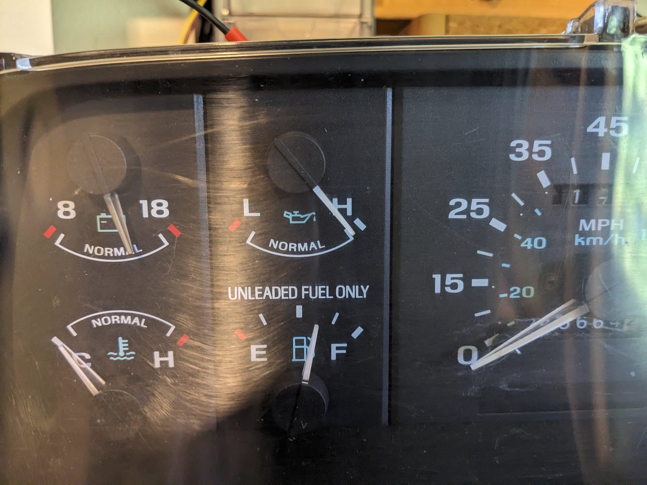

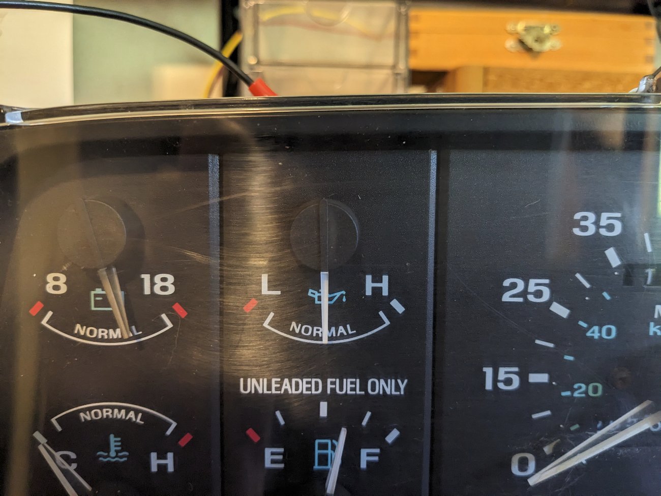

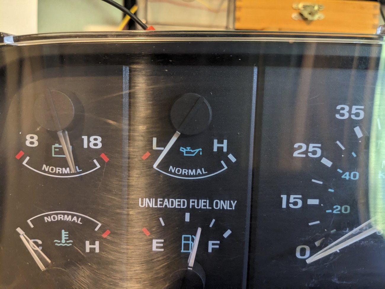

I know this thread is three years old, but this seemed like the best place to ask. I have a 99 ranger, and I swapped out my dash for one with a tach from the same year. I want the variable oil pressure gauge, but I can’t find the resistor. I took the cluster apart all the way down to the serval motor and I find no resistor. I hooked it up to twelve volts on the b and g terminals then put twelve volts to the s terminal and the gauge comes up to the normal zone. The gauge does not appear to have a spring but as soon as I remove power it drops down to low it feels as though it pushes against the stop point. Someone mentioned that some of these only operate halfway up the dash. I wonder if perhaps the gauge is twisted halfway in the opposite direction so that when power is given it can only go halfway up. If I were to remove the needle and reset its position it may work just fine. Am I thinking correctly on this?
edit: Well, I quickly realized my fallacy. I took it all apart and adjusted the gauge and either way it will only operate on half of the scale. Now I’m wondering if I could buy an oil pressure gauge from and eighty seven ranger and swap out the servos. Or I still have my old dash and I might be able to use the amperes guage off it and add a resistor and swap the servos. Will an eighty seven ranger guage work?
