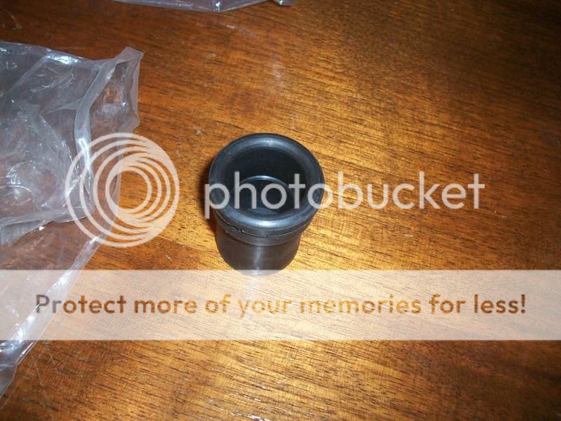

They came in today.
They have fancy grommets, they have a kinda odd size hole but they are intended to keep oil from getting sucked up.

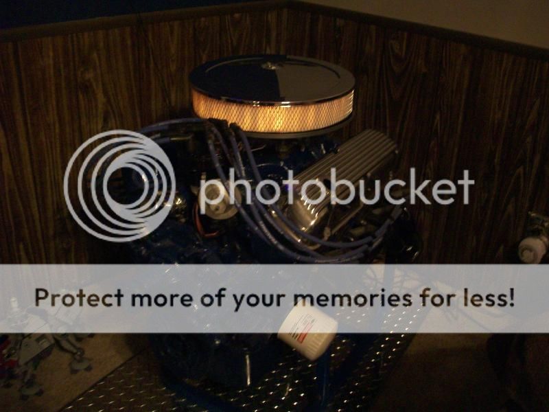

So I go over to the 289 lamp in the corner of my living room to see if they fit better than they look like they would.
The corners drag on the side of the cover sneaking it on with an open end wrench (which is totally not feasable in my truck) I could get different bolts but there is no way for them to bear evenly on the valve cover on the one end. This is only on the two very outside bolts on both covers, the one would be below the heater box and the other would be under the power steering pump where they would be kinda hard to keep close tabs on (worried about them backing out)
