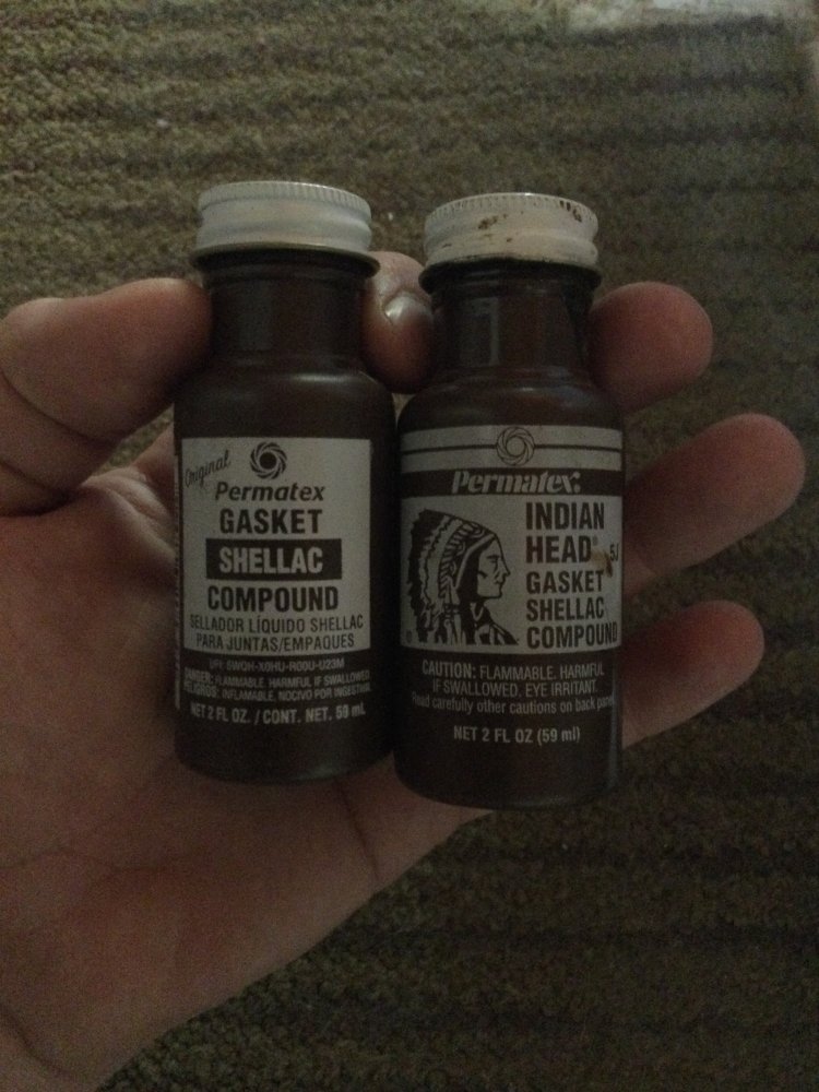

A bit of advice to be sure you don’t have to deal with the gaskets again, go get some Permatex Gasket Shellac (used to be Indian Head Gasket Shellac). I know Autozone has it, not sure about other places. I smear it on the head and the valve cover and set the gasket with it wet usually because it’s a pain to do it the way you’re supposed to. Works amazing, if it ever has to come back off be prepared to have to persuade it with a dead blow mallet.
Indian Head is awesome for cork, not really necessary for rubber and not needed at all for the Fel-pro perma-torque valve cover gaskets - FYI.

I’ve had rubber leak. Both cork and rubber get Indian Head for me. Never bought the perma-torque, but I have thrown away ones that were leaking…

Ive never heard of indian head
