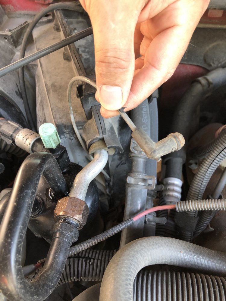

Hi everyone. I'm attempting to fix an AC problem and discovered this gray vacuum line in my truck isn't connected to anything. I saw a Youtube video where the guy connects it to a valve that my truck appears to be missing, or maybe it's located somewhere where I haven't found it yet. For reference, my truck is a '98 4.0 OHV xlt 4wd auto.
What I'm wondering is if some previous owner just capped off this line and if so, where and to what is it supposed to connect? Below is a photo of the line in my truck- notice the bolt screwed into the end of the L-connector to cap it. This gray line, along with a black line, run to the passenger side firewall underneath the blower box. Since I've owned the truck (4 years) this gray vacuum line has been just sorta flopped over the AC lines right about where I'm holding it. Thanks.

It connects to the heater hose by-pass valve which has been removed from your engine bay
It would be where the heater hoses have been spliced together, seen in your photo
I was only used in MAX AC setting to cutoff hot coolant from flowing thru the heater core
But it should be plugged, and looks like it is, or the recirculated air vent won't work in MAX AC setting
Bypass valve looks like this: https://www.oilburners.net/articles/pictures/valve2.jpg
The vacuum line would plug into the black cylinder on the top, and close the valve to cutoff flow thru cab heater core when inside switch was in MAX AC only
These often cracked and leaked, so were removed, outside of MAX AC cooling maybe losing a few degrees it doesn't effect operation of the vehicle at all

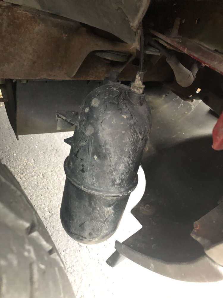

Just to update: I went ahead and ordered the Dorman Vacuum Reservoir from Amazon (for I think around $12) just in case I needed it and waited until it arrived to open up the wheel well. So Friday evening I removed the wheel well and found the Vacuum Reservoir dangling in the cavity by one vacuum hose. The bracket that is part of the reservoir had broken off so it had just been bouncing around in that cavity for I don't know how long. The vacuum line to the firewall had broken off at the boot attached to the reservoir.
45293
To get to the bolts that are supposed to hold the reservoir to the truck body I had to pull out my air box. The process itself wasn't too difficult- just a little bit of a PIA due to the location. Got the reservoir attached, used a 7/16" inside diameter rubber hose section to re-splice a break in the disconnected line, and reattached it to the reservoir. The most difficult part of the whole process was removing and reattaching the wheel well piece since my truck has those flares around the wheel wells.
Tested it out and it worked great: I never lost AC at any point while driving. And on the 1200-ish drive to Georgia it worked well the whole trip. Also, truck made it with no problems. This is the second long-distance trip I've taken the ranger since replacing the engine and many of the engine components a couple years ago.
