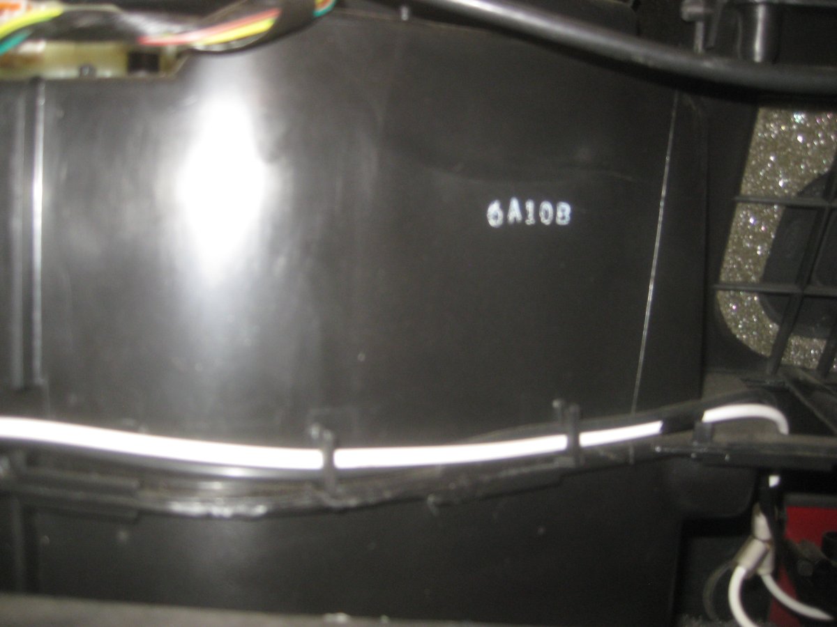

In the pic the right hand hose from the engine has to be the "in" side. When it's on "heat" it's allowing coolant to the right hand heater core hose, as you look at the pic.
When the engine is pretty warm with a thermometer I measure 155F on the outside of the hose from the engine, and about 125-130 at both the heater hose so that's quite a differential. If I set it to heater the core hose rapidly gets to 155 and with the fan on you see a significant differential for the "out" side of the core and at the return hose for the engine.
So that just seems like everything is working as well as it's supposed to work and I think there's just a little heat that still gets to the core but if you were driving and/or had air going through it for A/C it probably would be a pretty insiginifican't amount of heat actually getting in there.
