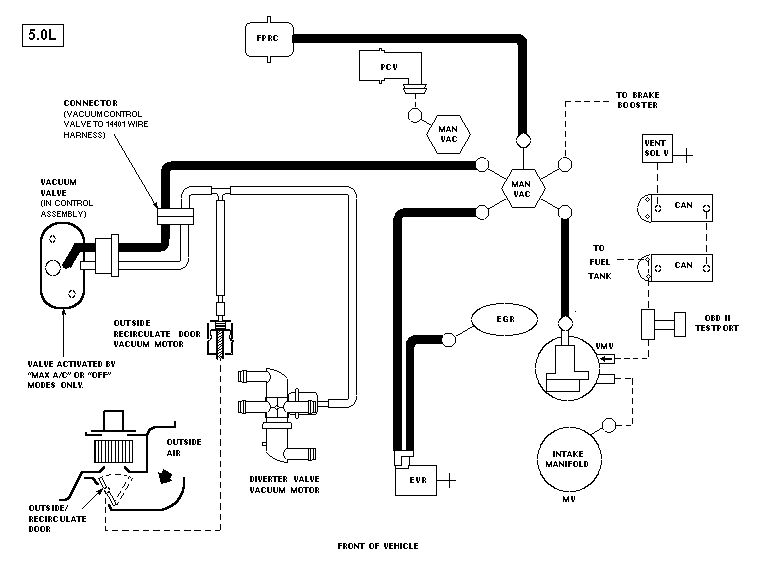

Hey Guys I just bought a 99 Mountaineer and everything fine and good till I got home and drove it the next day and the Check Engine light came on. I checked the Codes and they came up as p0171 and p0174 so lean on each bank. I will change the fuel filter to see if that will help. But I would like a Vacum diagram for a 99 mountaineer with the 5.0l. so I can start chasing down that down before I head home. thank you guys.
I'll dig one up for you later on tonight.
Could not find it in the 99 manual...found it in the 98. Should be the exact same.
