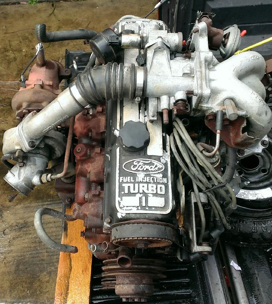

OK! So here we go! I purchased a 1997 Ranger XLT Single Cab with the 2.3L (8 Plug) and 5 speed about a year ago. About 4 months ago, I wrecked it into an Accord. I had big plans in motion, at the time, for a VERY EXPENSIVE N/A Build I was going to do with my tax returns. It was going to cost well over $2500 to reach any type of goal I had set for the truck!
That said, after the wreck I decided I was going to sell the Ranger and just start over with another 2.3L build... I started looking into turbo stuff and contacting ppl about motors and other turbo lima motor parts.
I ran into a guy while looking for a motor that was an ABSOLUTE freak of taking these 2.3T's out of Thunderbirds and putting them in everything from old Falcon Vans to his 87 Mustang LX (SUPER SLEEPER!) This guy KNOWS ALL THINGS about the Turboed Lima, its actually quite RIDICULOUS on how many freakin parts he has! LORD HAVE MERCY! Its INSANE! That said, without this guy, Chris, I wouldnt be where I am today on mg build. I'll leave it at that!!!
Well, after meeting Chris, I started talking to him about plans, what vehicle to get, etc. All while still trying to find a damn motor. Ge told me to KEEP the Ranger and just roll with it! I loved my Ranger, so I was ALL for it, it started getting stripped down and I already had Mustang seats installed. This was going to be one BADASS truck if i could find the PERFECT motor!
I eventually came across one!!!!! A COMPLETE ONE at THAT! The motor had been sitting for 20 years, but had been garage kept and turned over by hand occasionally. They wanted $500 firm, I walked away with it for $300 CASH MONEY!
I had Chris come by to look at it, as I was disassembling and so forth for the complete rebuild. He was AMAZED at how good the motor looked and how it hadn't been dogged (lots of carbon buildup) and that it had EVERYTHING I NEEDED except a wiring harness and ECU!

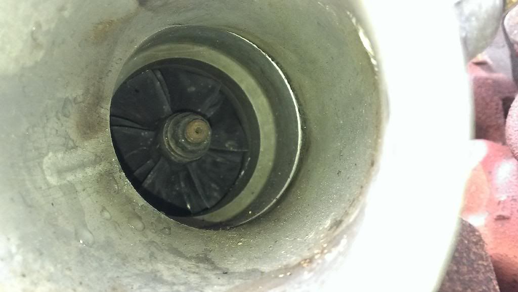

I got to work, as did He. I replaced every single gasket and replaceable part, EVERYTHING and had Chris do a valve job on it, along with a little porting and so forth. We did a turbo swap to the ITI Turbo and 88 Manifold. Straight trade. It was FRESHLY rebuilt and tthe Garrett that was ON THE MOTOR wasn't even spinning, come to find out, all he got was a HOUSING and a worse manifold out of it! Lol... But he could care less, as he has enough parts to build 79 Turboed Lines. I acquired A LOT of the parts I DID need from him and my NA motor I was buidling (1988 Mustang Motor NA).

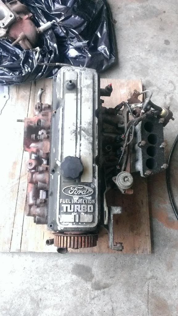

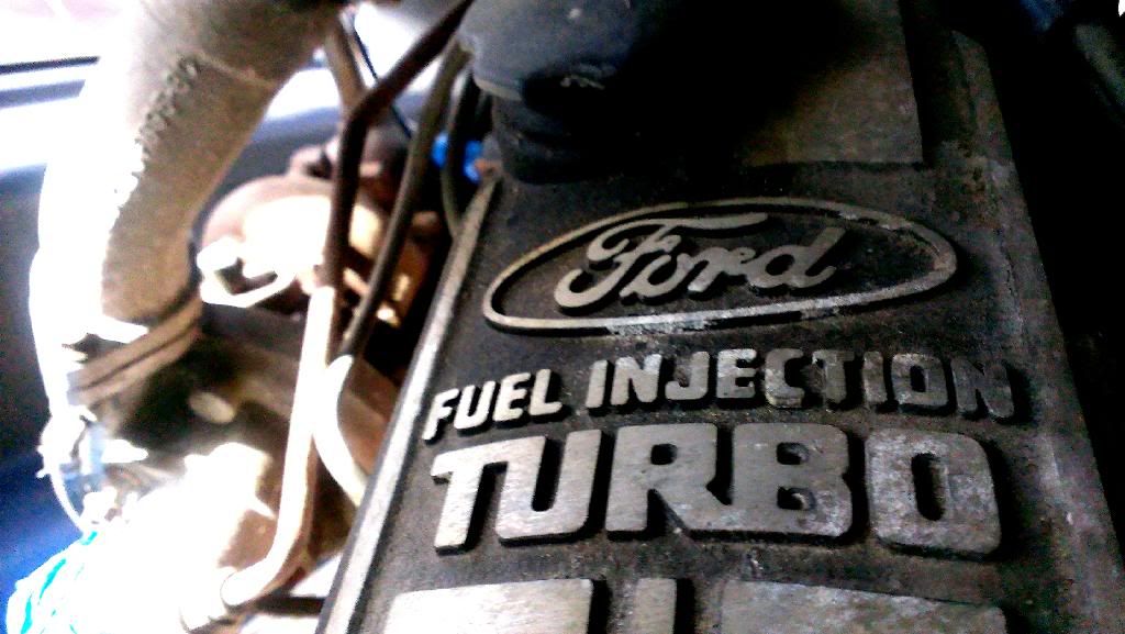

First time I laid eyes on my motor and then me riding home with her! Giddy as a schoolgirl!!!!
Dropped it on my tailgate and started cleaning/disassembling and preparing it for the MASSIVE amounts of surgery she's about to receive.... Let the pics keep rolling!

OH! DID I MENTION NEW ITI TURBO?!?!?

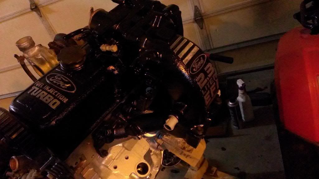

MADE MY OWN EGR BLOCK OFF PLATE.... EASY ENOUGH!!!

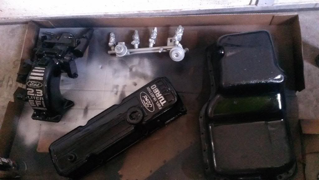

NEW FUEL RAIL AND BROWN TOPS NEEDED SOME NÉE PAINT AND REFRESHMENT!
NOW WE'RE REALLY STARTING TO LOOK SEXY!!!!
:D
Nice build thread...except those images...lol...but it did make me feel like I was sitting right there in your driveway looking at that motor...:icon_thumby:
Yea... Ummm.... That's JUST when I FIRST picked it up and laid it down! There's a TON more and I'm going to continue to add photos until we're ALL caught up! Then after you see and know everything that's going on, you'll be pretty impressed! I'm sure!
That motor looks COMPLETELY different then it does now! Its a must see build...!

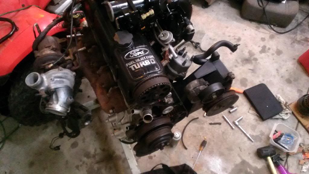

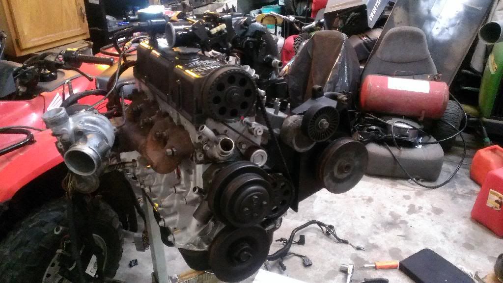

WHERE WE STAND.... RIGHT ABOUT NOW!

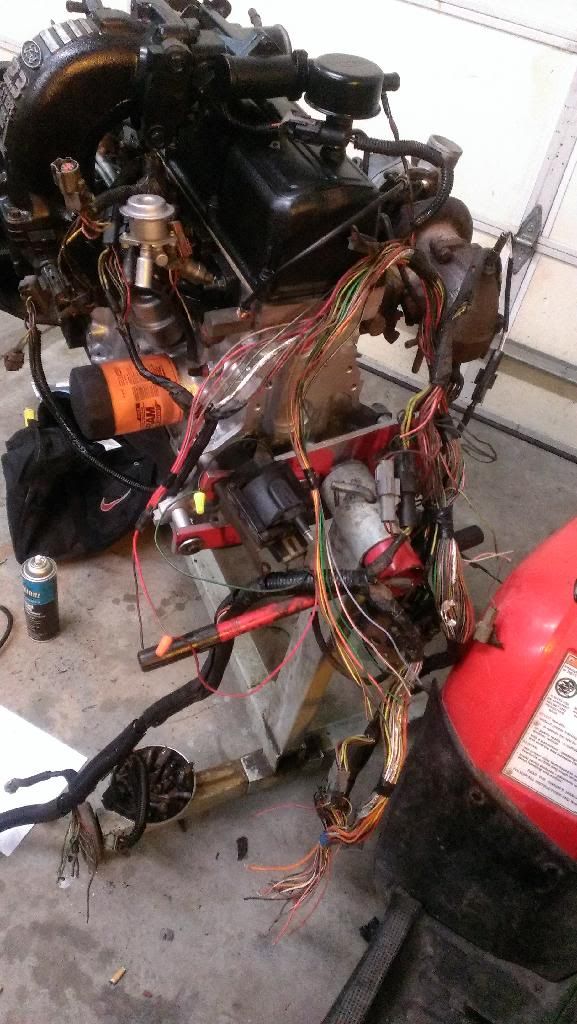

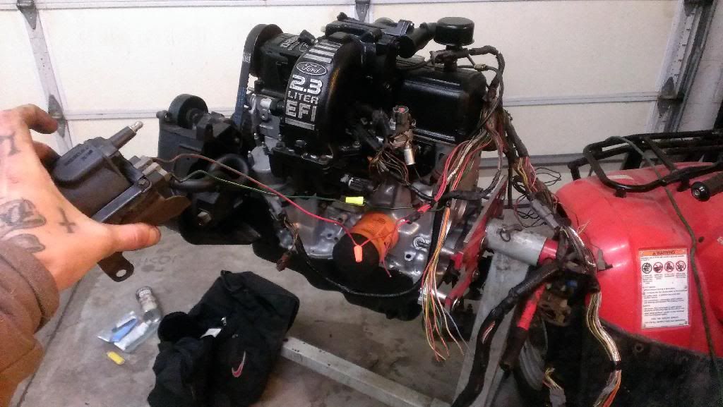

Wiring harness being installed and stripped of whatever is NOT being used!
"I NEED AN LA3 PARTNER FOR LIFE!!!!"

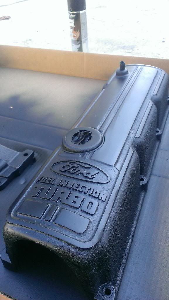

Technically this would be an SVO (Special Vehicle Operations, the forerunner to SVT), not a SHO (Super High Output) since the 2.3T was an SVO engine, the SHO engines were worked over 3.0s, or small displacement Yamaha V-8s.
Also, pretty shiny valves.
I hope you didn't do what I did and used regular paint on that...even the oil pan gets dang hot to the touch and it will burn off regular paint in no time...
It wasn't until I did the header in, what I thought was, high heat paint that I learned the temperature on that side of the engine requires very high heat paint...like the stuff they paint flames on the sides of old cars in...lol
Yea that was an ERROR! NOW I CAN'T FIX IT!!! Can I get some Admin Help for that?!
Its ALL painted in VHT Header Enamel - coated 3 times after an initial High Heat Primer. Then it was ALL coated 3-4x's in High Heat Clearcoat, also made by VHT. I don't think its going anywhere SOON, atleast. :icon_thumby:

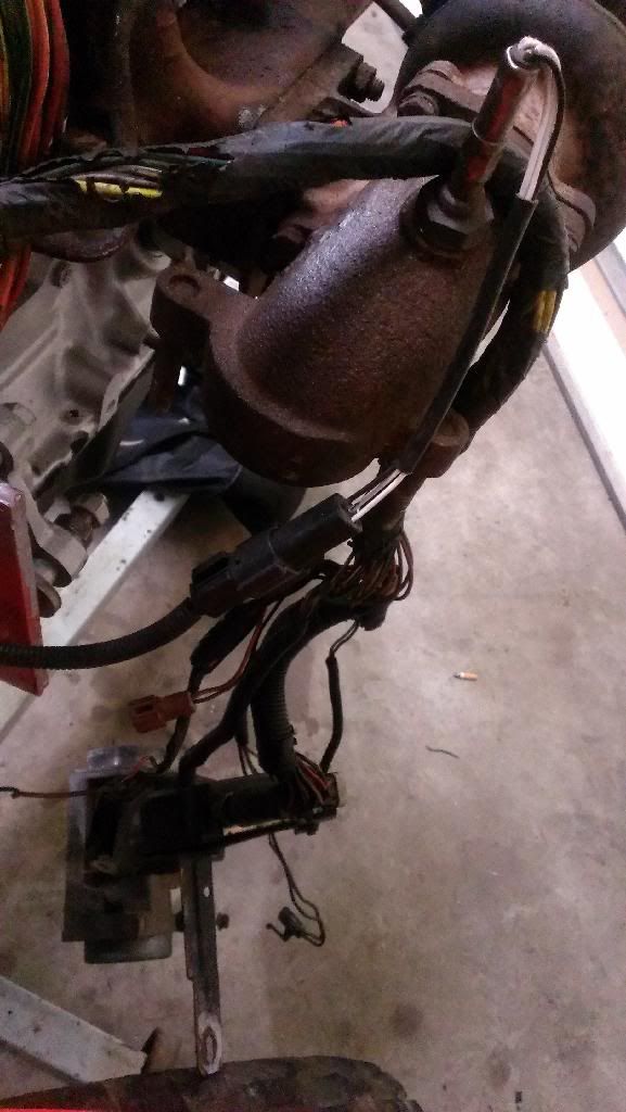

Got MOST of the wiring harness in, not sure what SOME of it does though?! Mostly the LONG black wrapped part that plugs into nothing it seems like (but a main ground IS on it!) I would like to weed threw ALL the pins I'm not going to use and have it ALL ready for the drop in! Can anyone help there???? It would just make the install CLEANER and EASIER!
ALSO, MY 2 WIRE HARNESS FOR MY COIL WAS CUT! UGH! So I just matched the colored wires, in HOPES that's wtf its supposed to be! (Check pics!) If anyone knows which two pins it is that go to it, I could figure it out from there. I can't find it on my schematic!!!!

I also got my power steering pump/pulley in, along with the tensioner pulley n bracket for the altenator!
THIS IS THE KNOCK SENSOR CORRECT?????
And this is at a stand still for now :(
