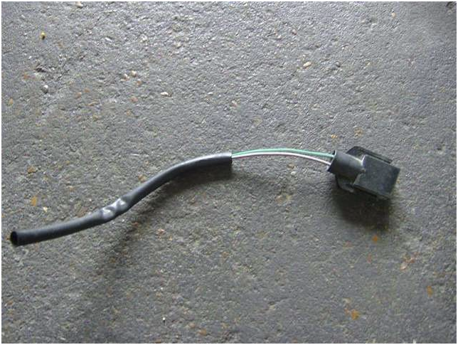

Using the Ford CD and a pigtail, I wired up the dash lights for my transfer case. It was easy.
Besides the case, obviously, you need:
• approx 10 feet of small gauge wire
• wire connectors
• relay (optional)
• wiring diagram of your vehicle
This is an easy job to do and in my opinion worth the effort.

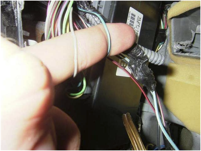

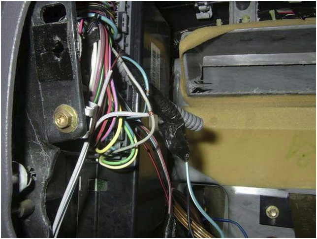

3. On the left side of the hole in the dash, the GEM is mounted vertically.
4. Using your wiring diagram, locate the two wires that go to the dash indicators. I would think many years would be similar, but Ford likes to change things up, so do your research. My wires were grey and light blue w/ black stripe.
V8 swap, tcases.
5. Now that you have the wires located run the wires from the dash to the bottom side of the body. I ran my wires under the carpet to a plug in the body about the size of a quarter that came out just on the outside of the frame on the drivers side.
6. Wire the wires to the two coming from the pigtail. It doesn't matter at this point which wire is which, so just hook them up.

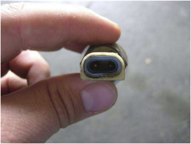

7. Find your shift indicator switch on the transfer case. It is near the shift fork and takes a 22mm hand wrench to remove.
8. Route the wire away from the driveshaft and plug it into the switch. I ran mine from the plug over the frame, over the shift linkage bar, behind the vent hose to ensure id doesn't get near the driveshaft.
9. Go back to the cab. The two wires that you found earlier you need to strip some insulation away from. I just took a wire stripper and cut and pushed the insulation.
10. At this point, don't connect the wires permanantly. Pull your case into 4 hi. Taking one wire from the case at a time touch it to the wire that runs to the dash. Find the wire that lights up the 4 high light.

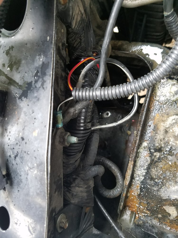

Ask as many questions as you like. That's how I built mine. These quotes are straight out of the article because everything is explained the best I feel. Pay attention to italics and bold closely they are the important information. The high pressure a/c switch is on the back of the ranger compressor. It comes out of the main harness on the driver's side of the radiator on the Explorer and the black wire/white stripe grounds to a stud next to it with the ground from the negative battery terminal.

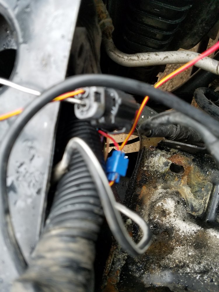

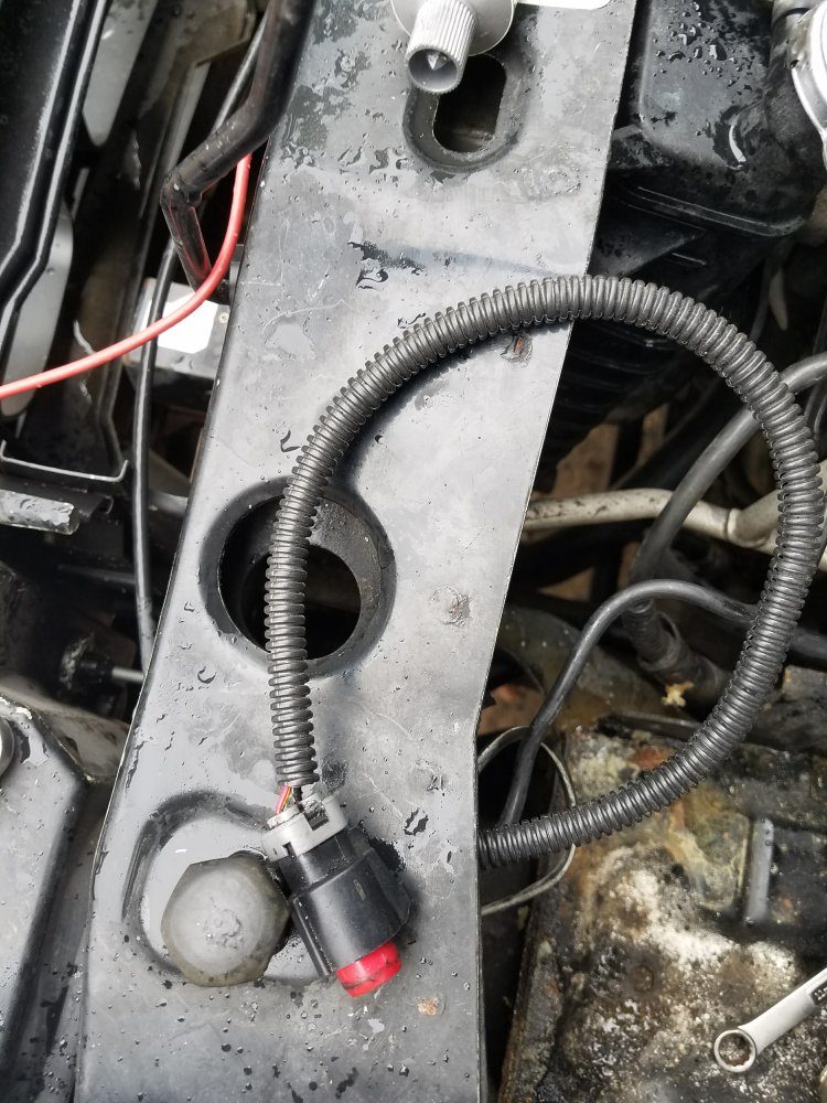

So I found the red wire/ yellow stripe(a/c signal wire for high pressure switch) in the ranger harness to the right of the radiator. I spliced into it and wired the explore high pressure switch plug to it. The black wire/white stripe goes to ground. I grounded it right back to the lug with the negative battery terminal wire.
Solenoid wire plug
This plug is right underneath the lines that come off the abs.
The explorer and the ranger plug do not match up. (I think they were both male)
The Ranger plug has 5 wires
Yellow/white strip (Starter solenoid wire)
Red/yellow strip (signal wire high/low pressure a/c switch)
Black-white strip (ground for high/low pressure a/c switch)
Gray/white stripe(a/c clutch relay signal wire)
Black wire(a/c clutch relay ground wire)
Explorer plug has 3 wires
The reason the other two are not in there is because they come out by the radiator. So just wire up the 3 wire plug from the explorer and your good to go
As stated above this information is the best I can explain it. I know reading all the information at once sometimes it all blends together. Plus I built it in 2017 lol. Memory isn't the best any more. I'm working on getting some pictures attached that I found of the ac plug.
I don't know the bolt sizes for you are looking for. I have a bucket of bolts and usually find what I need in there lol.
Here are some pics of the ac plug. It shows where I wired it up at.
