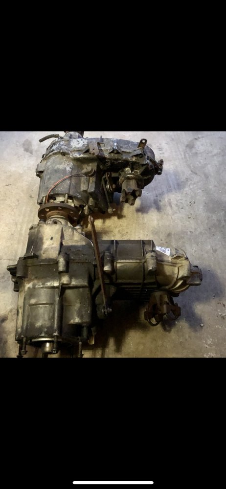

Doesn't completely apply to your specific application, but just to throw some more info out there. I'm finishing up a 5.0 swap in my '89 Ranger. Ended up going with a Jeep np208 transfer case behind the e4od, because the big bw1356 tcase that came with the swap wouldn't even come close to fitting. The jeep np208 is like 6inches narrower than the full size bw1356
for a size comparison. jeep np208 tcase on top, ford bw1356 on bottom.
depending on trans, the jeep case needs a spacer or you need to cut the output shaft on the 4r70 down a bit. i like the jeep case and have used them extensively, but they are very rare these days. even the 208 ford case are getting rare....which you will need to swap the 31 spline input shaft from. if you want to use the stock ford speedo cable, swapping the ford tail housing on from a fixed yoke bronco f208 application takes care of that. though with the later non speedo cable trucks its not an issue.
Does the bolt pattern of the Jeep 208 fit the back of a Ford trans adapter or is there another adapter required? Or just the spacer?
they are clocked the same. gm is the odd ball for those units.
