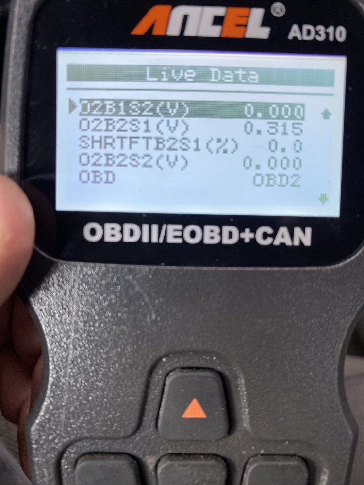

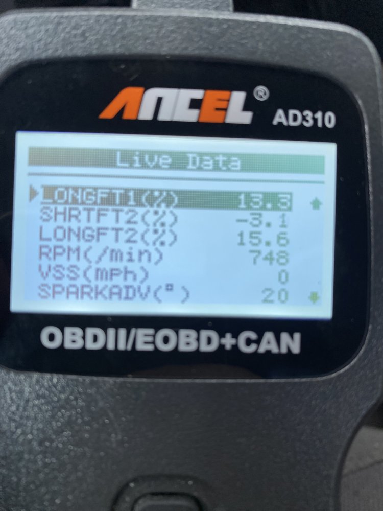

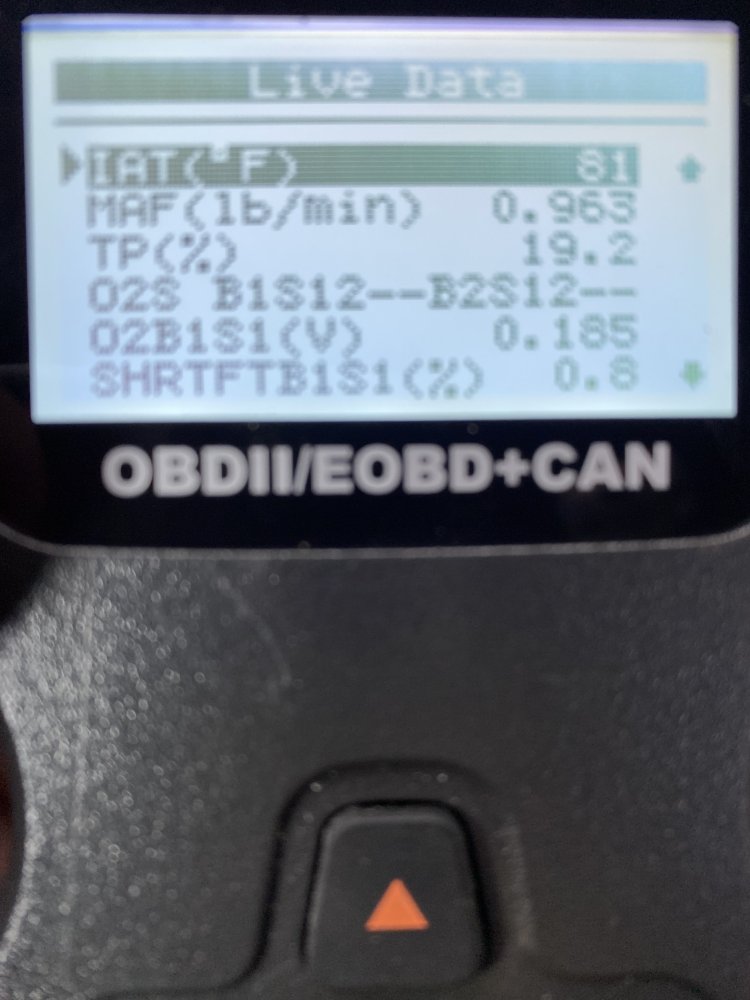

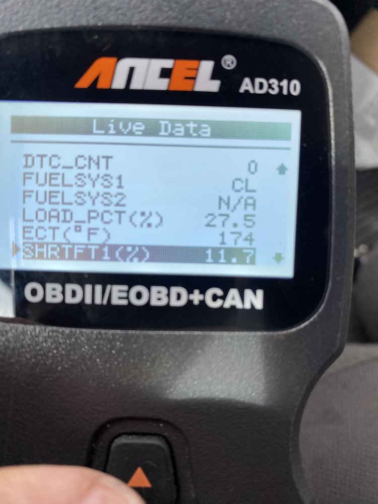

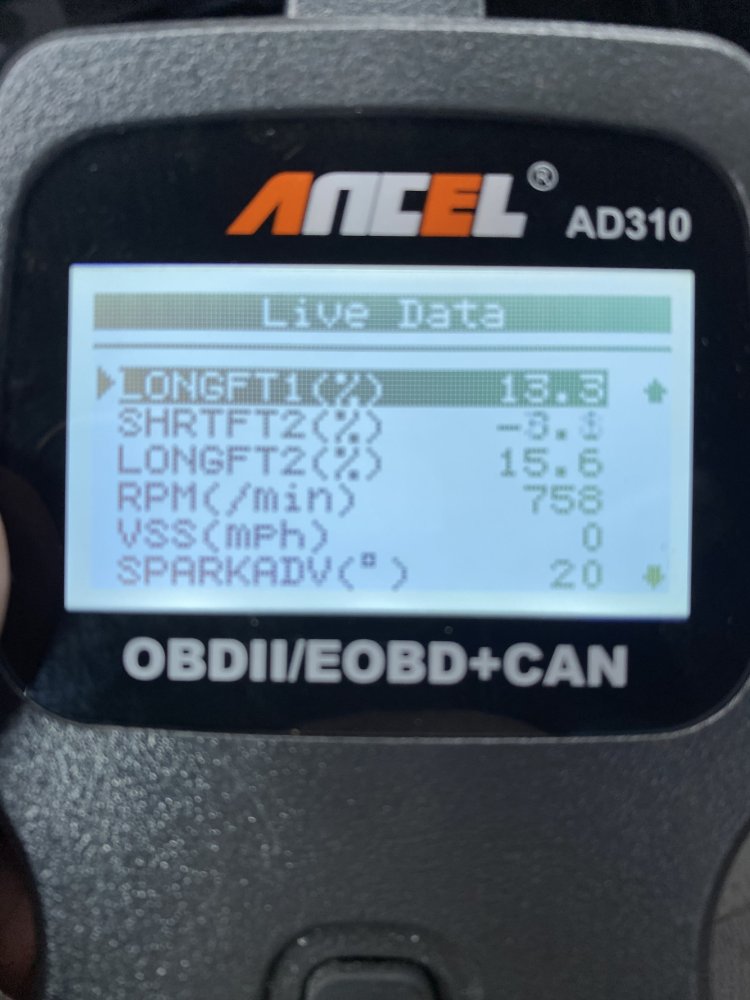

Ok, so I've finally been able to get in a decent amount of driving and my MPG still sucks nuts, about 10 in the city. All the things that have been replaced within the past month. IAC, PCV, Spark Plugs, Wires, all vacuum lines, Fuel injectors, 02 sensors (upstream). I realize that I'm basically just throwing money at the problem, but can't figure out how to get it to go away. Today I started looking at the live data and notice 1.) my engine (at operating temp) idles at around 650, and sounds not quite like it's misfiring, but more like a stumble every now and again. 2.) my long term fuel trim 1 and 2 are both high while I'm idling in drive (both are sitting at about 14-16. 3.) my Short term fuel trim 1 and 2 are sitting at their top range when I'm idling in park (both sitting between 8-11). 4.) my MAF was reading intake air between 60 and 85 degrees, though its only 40 outside. I didn't see anything else noteworthy, but I'm reallllly new to reading the computer live data for diagnostic purposes, so I need help. I have a new MAF sensor that I've been sitting on installing because I didn't have the special security star screw head set, but I'll probably install that today and see if it helps at all, otherwise, I can't think of anything it could be. All the parts I'm buying are quality parts and are reading "what I think" is accurately. The last thing it might be, thats on my mind is my coil packs, I bought some new ones off ebay for relatively cheap when I built the engine, I still have the OEM ones somewhere, but if the new aftermarket ones are already starting to fade, this could be the problem too. anyway. I'll attach some pics of the live data for comment, I know its not a vacuum leak, because 1.) new hoses and 2.) I've gone around with propane and tested all the hoses that way as well.

also I should probably note, My cats are both brand new, since I had to build the exhaust system for the 5.0, and my fuel filter was changed probably 5 months ago. and the guy who deleted the PATS system off my explorer computer also added an "87 octane performance package" to the computer, which, I have no idea what It means.

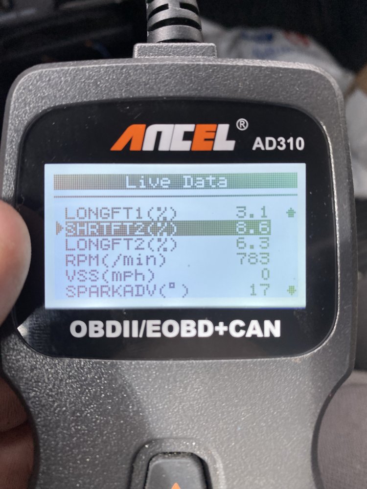

Also, I put in the new MAF, it brought the long term fuel trim down from 14-16 to within spec (barely) having them sit between 9 and 11.7. the short term is down too. but its still idling around 650 at stop lights, but a little bit smoother of an idle.
