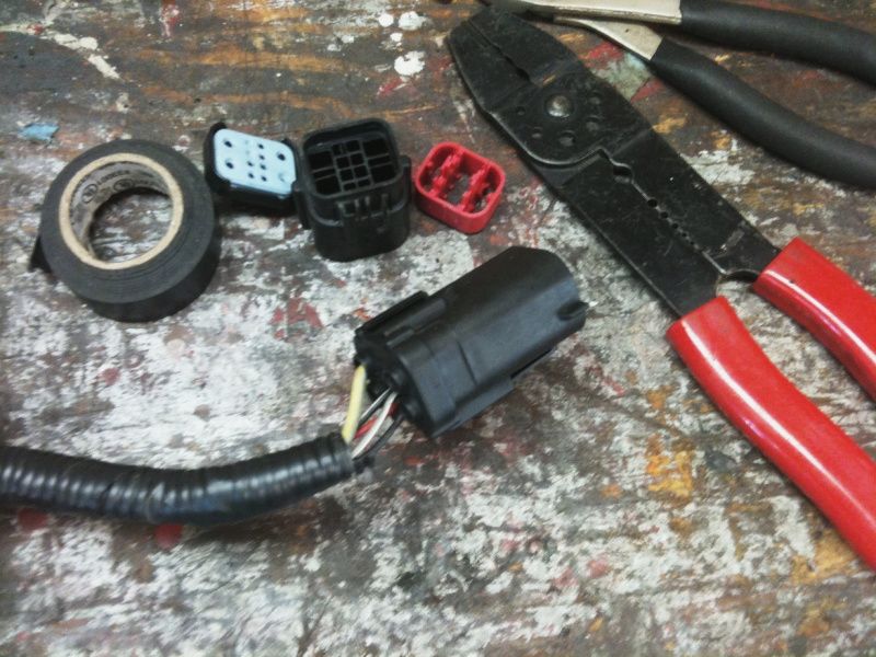

The 97 mountaineer battery harness should work. Except there is one plug under the brake master cylinder that doesn't match up and will need to be spliced. The other connections... to the starter and alternator... should be fine.
The connector under the master cylinder, is that the solenoid wire and the 2 wires to the AC compressor? Are there any other connections off of that? Do you happen to have the wiring diagram for it so I know what pins are what? :)
The alternator wires in through the main engine harness does it not? The truck is not in my garage or I would just go look. I think I have all the wiring done except this last thing. Everything else just plugged in like it belonged there.
Again, thanks for your help!
I used the charging harness from the 5.0 but I modified it to plug into the ranger (under master cylinder). What I did was splice the ranger charging harness plug (from the 3.0) onto the 5.0 charging harness. Worked perfectly.
