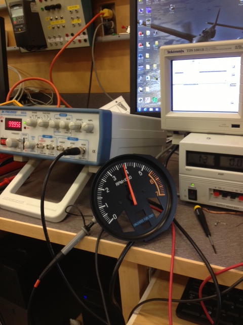

Calibration of the tach is done with a precision resistor thats twisted on to terminals at one end of the circuit board. I'm guessing a technician did this at the factory. Once mine was up and running on the bench, I noticed it was high by 5%, so I added another parallel resistor to bring the reading down slightly. I was able to get it bang on 3000RPM for a 100Hz input signal;
3000RPM/60seconds = 50 revolution/second
50 x 2 pulse/revolution = 100Hz
So to indicate 3000 RPM, I need to generate 100Hz (1500RPM = 50Hz and 200Hz would be 6000RPM.
Higher resistance at this location means higher tachometer reading, while lower will bring the RPM down for the same frequency input. In theory these tachometers could be easily calibrated for a almost any number of pulses per revolution. Pretty simple actually.

A little late, but here's some pictures of the calibration resistor and the tach running in the classroom lab.
The 3900 reading should actually be 3000, but the calibration resistor has been removed to show the effect (Higher resistance = high RPM). adding a resistor in the k-ohm range would bring the reading down into the hundreds for the exact same frequency. Its actually pretty easy to calibrate if you have access to the equipment.

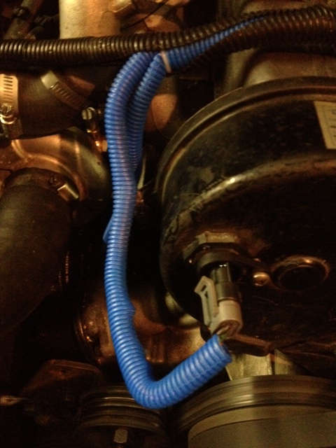

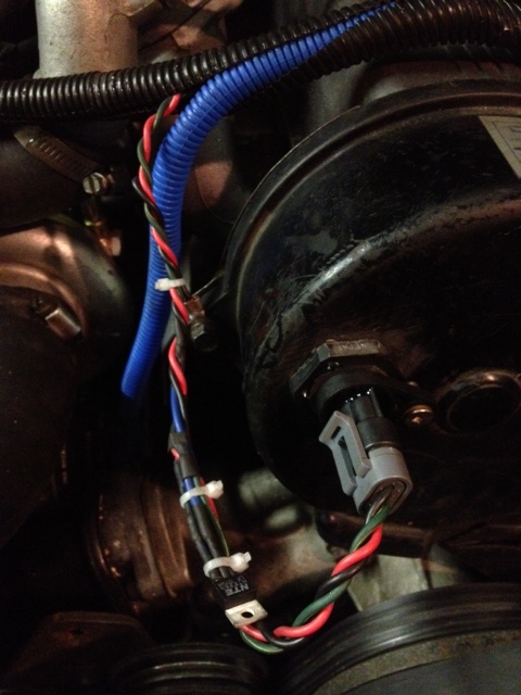

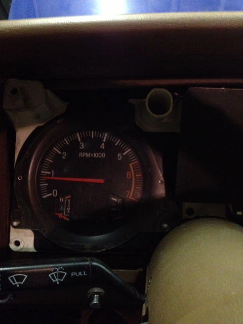

Here's the setup as installed in the truck.
The hall sensor is installed in the timing cover and aimed at the camshaft sprocket (4 spokes at 0.5 crank speed = 2 pulse per revolution). Basically, its set up as a camshaft speed sensor.
The catch with this particular sensor is it only puts out a 0.4V pulse. To solve this, I sent that pulse into a Darlington Pair Transistor to act as a crude amplifier. That got the pulse up over 7V. The tach seems to run well on anything above 4V.
I considered adding the darlington inside the cluster assembly, but was concerned about added interference on the long wire leading to the cabin. If this location proves too harsh for the circuit, I may decide to move it later. Darlingtons in this size range are dirt cheap so its no big loss.
The 12V is parallelled into the fuel pump circuit and the ground is simply taken from one of the cam cover attaching bolts.
And so far so good!:headbang: I already test drove it and the readings seem bang on and very steady.
