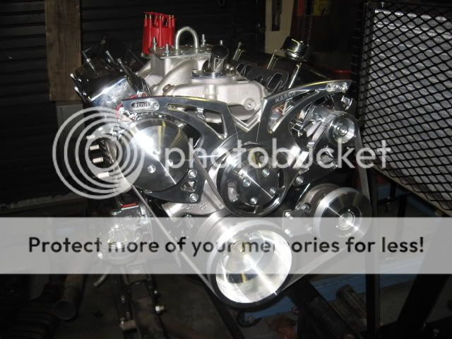

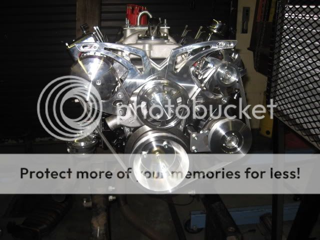

You can use whatever you think looks best. New aluminum "March" style brackets are available around $100 for both alt and PS.

march stuff looks awesome, but stock stuff is cheaper
