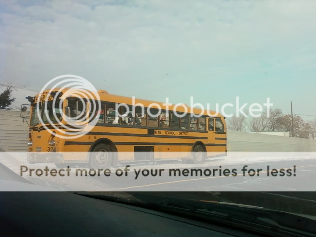

hey shane here is another "magna fun" tidbit:
look wht my classy neighbors with the "junkyard" across the street have had parked on the street for the last week or so, it is in fact a delapidated school bus, filled to the brim with garbage :icon_twisted:

That's fabulous. If that thing is not registered I bet you could get the "Magna Mafia" to give them a ticket. You could always give it a little bump into the ditch there. :buttkick: I don't make it over on your street too often, so I hadn't seen it yet......usually only when I'm cruising around.
On a side note, I always have wanted to drive one of them Gillig's with a manual transmission.
it has a dealer license plate stuffed in the back window.......so the magna mafia won't do a thing
