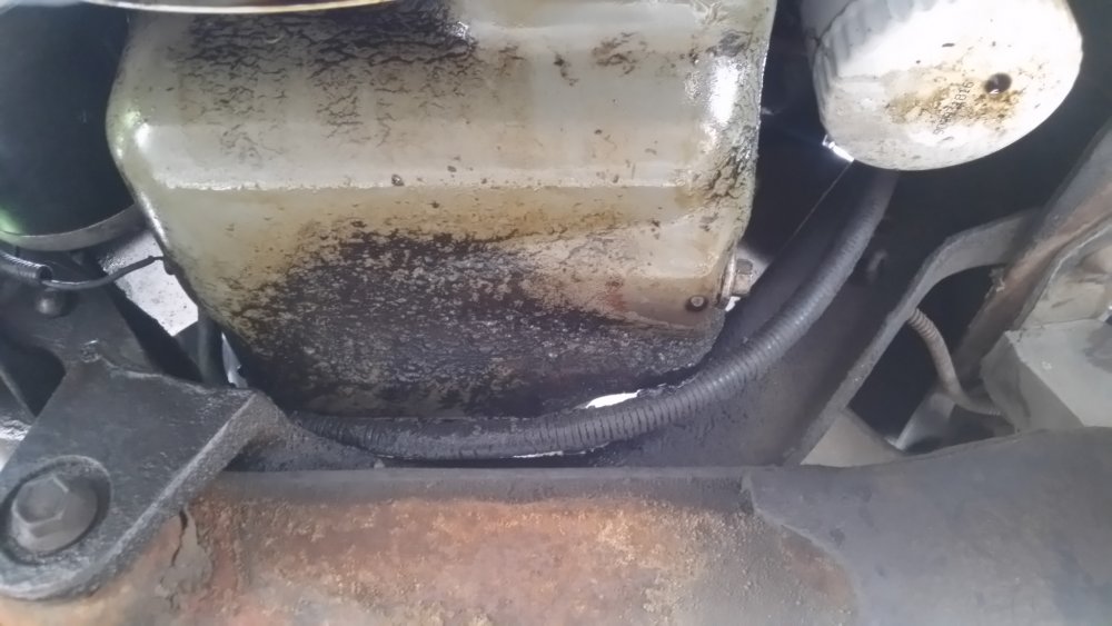

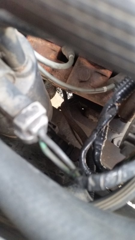

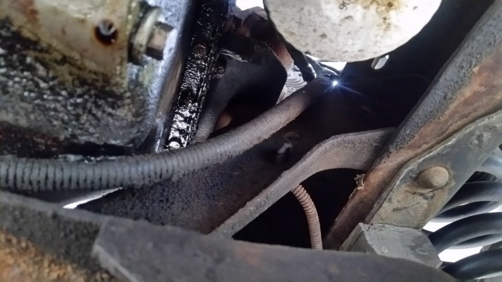

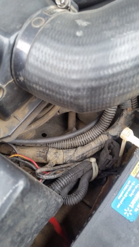

You pretty much just take the shortest route (yeah, I know that doesn't help). In the area of the air intake between the radiator support and the air cleaner box, the plastic air duct comes straight from the radiator support, makes a sharp turn up, then levels out again, before going into the air cleaner box. The battery cable routes just after the sharp turn up and under where it levels out. Then it goes down behind the back of the motor mount, and under the oil pan on the back side of the engine's cross member. I put the pictures in that order. I hope that helps. The battery cable is the dirtier sleeved cable in the very center of the first two pictures.

It goes under the oil pan! Aaaaaahhhhhh! I kept trying to go over the transmission! I'll try that. Thanks!
