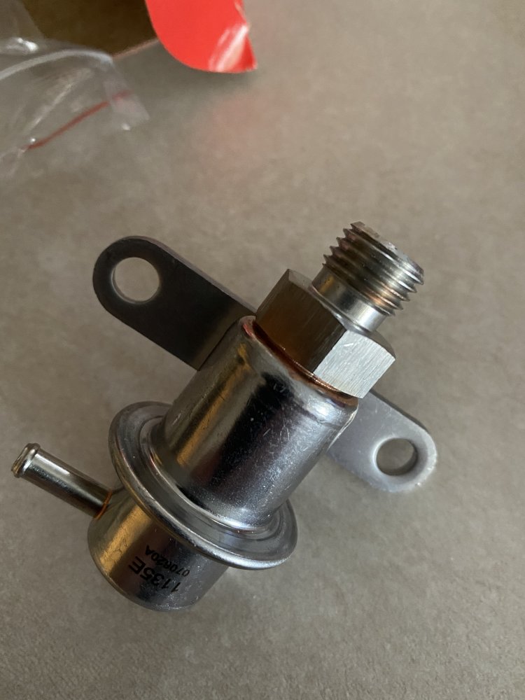

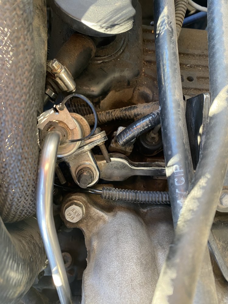

I discovered my problem . My Fuel Dampener in my 1998 3.0 4wd , it is leaking fuel through the diaphram into the vacuum port/ line . Im now in a a jam. SOB's dont make the part anymore!! I ordered one that said it was for my truck but when I went to hook it up , it has a threaded end and my hard fuel rail line has a ford spring lock connector. Now Im trying to figure out if I can use an inverted female union to connect another spring lock port to then connect the hardlin spribglock . I need help urgently on what parts to use or change . What a SOB of a problem because these moron companies dont make such a simple part . I bought part FDP20. the original part FDP22 is no longer available. I think this is a 3/8 threaded male end ( it has a concave tip for a flanged union ( inverted??)

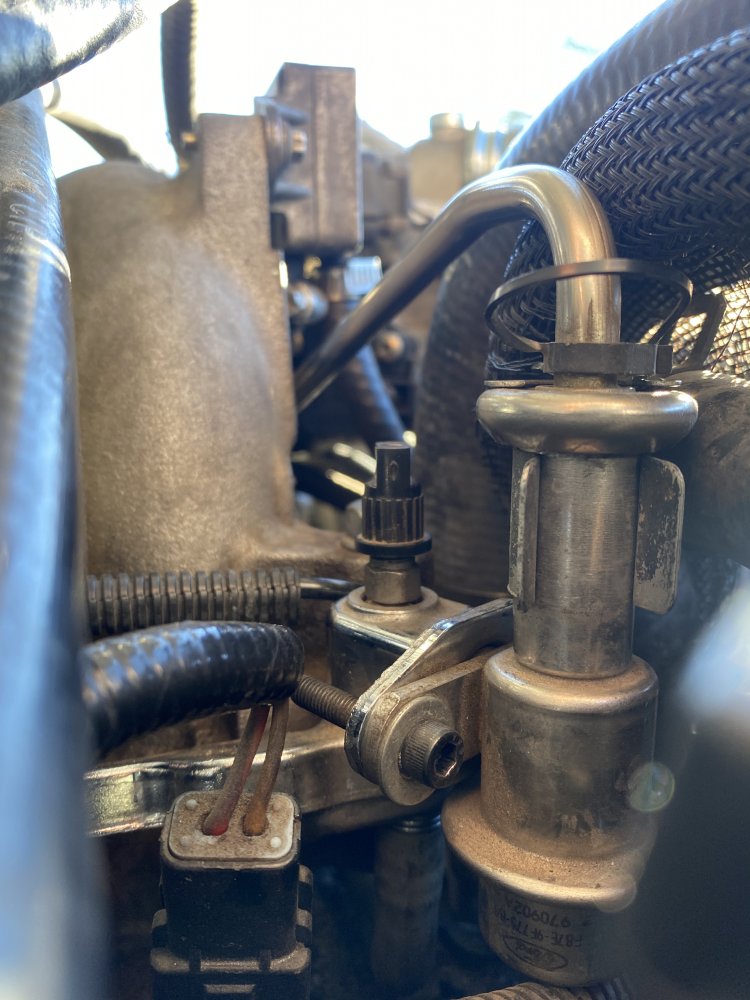

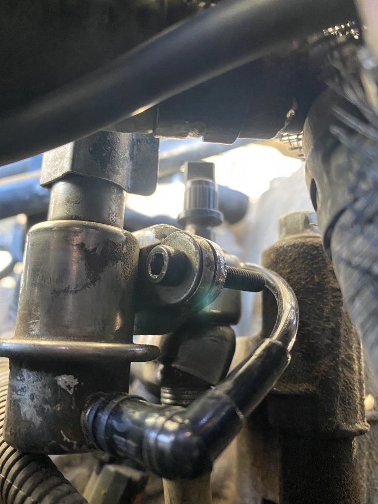

saved more photos of the oem part on my truck that is failed. I can't find FDP22 . See the spring lock connector? Whoever designed these ac lines and fuel lines with spring locks are SOB s !!!!!!

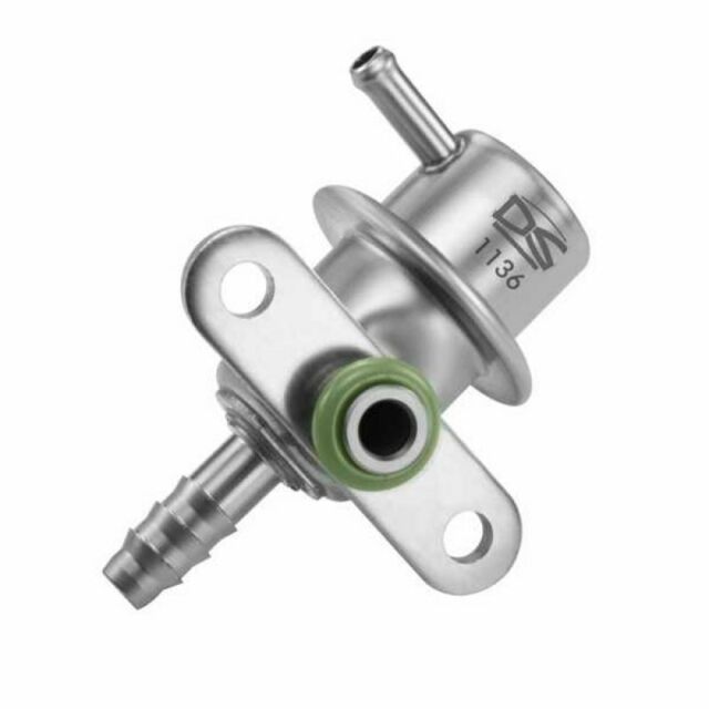

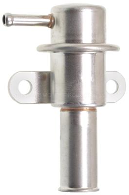

What I see in your photo of the replacement item is a 4l fuel pressure regulator, not the 3 L item, the 3L pressure regulator has a barbed end not a threaded fitting.......
Now I've not had to replace mine so I've never paid much attention to it.....what you require is this?
53241
For the one above with the barb on it, I am coming up with a Herko PR4156. But it says it's for a 3.0 ranger 1999-2001. Yours is a 1998. For a 1998-2000 ranger they are calling for a Herko PR4029, which looks exactly like the one the parts store already gave you.
You may have a half-year model, Ford is famous for changing things mid-year if you think the later one would work better. But I was studying the pictures in this link https://www.amazon.com/Automotive-Pressure-Regulator-PR4029-Explorer/dp/B06Y6G7NPM/?tag=959media-20
I am suspicous that the one you bought takes some sort of o-ring type fitting. I would pursue taking your original one apart. Try unscrewing that end that matches the threaded end on the new one and see if it unscrews.

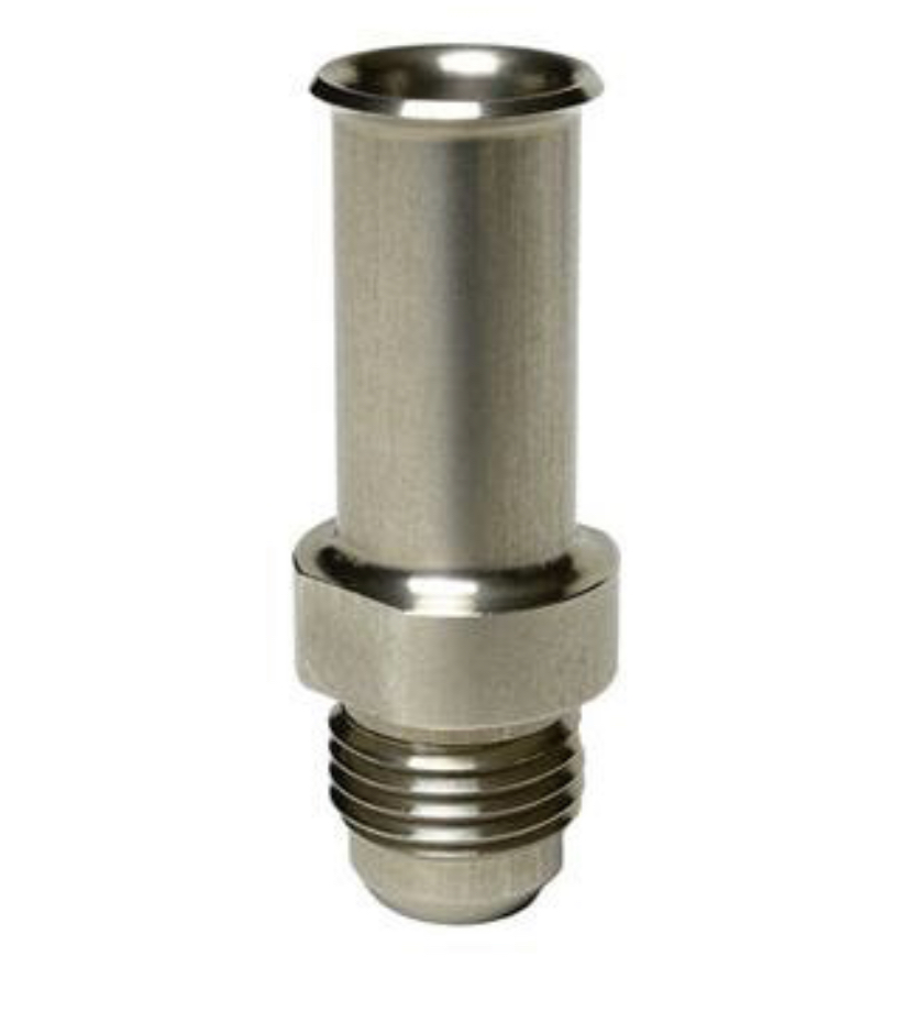

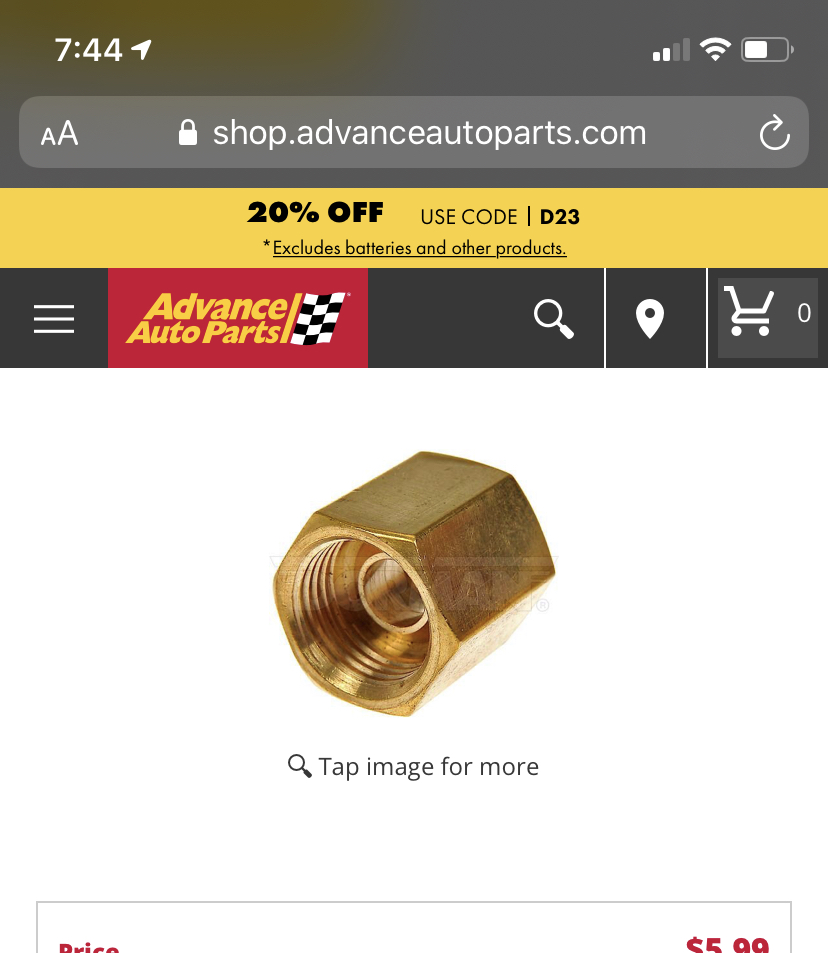

this is my progress solution, I need help. I need anyone knowledgable with modifying or using adaptors on fule lines . I need a -06 AN ( army navy) adaptor that is 3/8 inverted female union. Im also unable to confirm if I neee the top of the female union to be inverted also . Im assuming both flanges of the female union would be inverted to marry the adaptor and the regulator .https://shop.advanceautoparts.com/p/dorman-inverted-flare-fitting-union-3-8-in-785-316d/11910802-P
