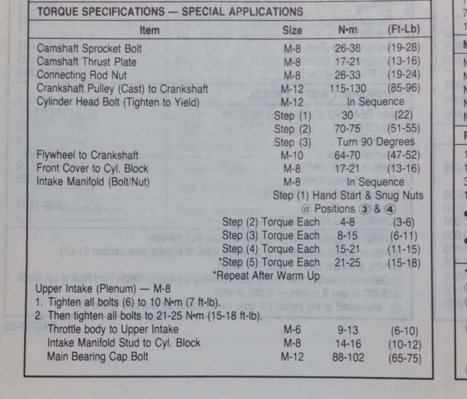

I dont recall ever seeing one, but is there a torque spec for the upper plenium?
I can hear something sucking air and i got a high idle.
I used a 1/4 in drive to tighten it because my 3/8 blew the guts and i didnt get a different one yet, and im afraid of snapping/stripping them with a 1/2 in drive.
I havent started spraying ether yet to see, but just wanna get an idea before i start chasing lines.
Here it is.
Hmm....15-18 ft lbs? Doubt i came anywhere near that with my harbor freight 1/4 in.
Ill get the torque wrench out and do it right.
Thanks bud.
