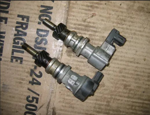

top is original style, 93-95. bottom is 96-98. both are 3 wire, simple hall effect sensors. different plug but the wires are the same colors for reference when installing new plug.
this isnt my pic, i replaced with a brand new unit that was 55 dollars with alignment tool off rockauto.

ive seen 3 style of sensor/synchro.
early style 93-95(3wire), which is what i removed is top one in photo, bottom of photo is what i replaced with, 96-98, 3 wire, 123mm length( as stated in original post) different plug, same wire colors though.
theres a 132mm option im not sure what its for but doesnt fit the 93-95 so doesnt matter, didnt see where or what they fit.
