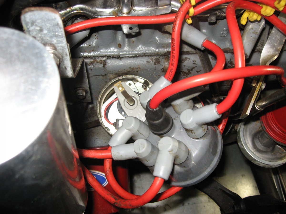

Grumpaw, I still have an old analog DWELL METER and flashing timing light. My 32 was driven all over the south with points and it NEVER left me stranded. With a Mustang 289 V8 and points my next Street Rod was a 1940 Ford coupe, it did the same and ran great. I use BWD Select ignition parts (points, rotor, cond., cap), an ACCEL coil, a MSD 1 ohm ignition resistor, solid copper plug wires, and platinum plugs. The computer allows for great timing control of fuel-air mixture and spark...but requires lots of sensors to be accurate. Think about this: we could time a machine gun to fire between the propeller rotations in WWI...and do it mechanically way back in 1918. It may not be High-Tech but mechanical ignition timing also works, and it still does so as fast as a computer...at road speeds. In the 4-cylinder points open and close at half the rate of a V8, and points are only a switch to turn on/off the flow of currant. The spark of a points system is longer than a computer spark and more likely to ignite the mixture. That is a proven fact.
