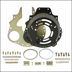

the only referenced vendor for T5 adapter (Advanced Adapters) has an update that says no longer doing the parts.
I found today that Modern Driveline sells both a complete package:
(which includes the T5 tranny for a whopping $4k), but after you get done building the package they show you all the part numbers and the adapter plate you can find in their catalog
MD-401-1101
We'll bring this to @Jim Oaks attention.
@Brain75 The package you listed is for a T5 into a SBF swapped Ranger, not for a 2.9L V6 Ranger. The MD-401-1101 is a SBF bellhousing.
If anyone wants to try a T5 behind a Cologne in a Ranger, I'd suggest giving the 4.0L Mustangs a look. They may have a usable bellhousing.
I actually did see the mustang - RonD posted this:
2005 - 2010 Mustangs used the 4.0l SOHC which has the same bolt pattern as 2.9l, and came with the tremec T5, maybe someone has swapped to tremec T56 or newer Magnum 6-speed
in this thread:
and I came upon that Modern driveline by googling "T5 behind a cologne V6" - I would have swore all along each step of the page it said nothing about SBF, but yeah now that you say that I see it....
I doubled back on Modern Driveline's webpage and came up with this using different terms:
MD-401-4060
don't think that is the product I saw the first time, and I wouldn't know if that is the 4.0 OHV or SOHC from just the pic... it says "Ford 4.0L" for compatability and that is all it says...
at $1600 for just the adapter though that's kinda steep for my pockets.
Yeah, I've discussed the Mustang bellhousing in several places over the last several years. I haven't attempted it and haven;t run across anyone else that has, so I don't like to do more than throw it out there as a suggestion. If my old 2.8L ever makes it into a new home I'll be finding out first hand.
Good find on the bellhousing, but that's way out of my price range too. Pretty sure I could put together a whole transmission package based around the Mustang bellhousing for that price.
I quit.
Seriously though...
MD-401-4060
I think the bolt pattern on the OHV and SOHC is the same but I'm not 100% sure on that. I think they share the same lineage even though the block was modified to run the Rube Goldberg cylinder head design that the SOHC has.
I'm wanting to say that there is minor variation, but nothing that prevents transmissions from interchanging. For some reason I'm thinking that one pattern uses a bolt that the other pattern does not. Nothing about that bolt being missing affects the installation or usage of either transmission on either motor. Could be a different transmission pattern that I'm thinking about though.
They added one bolt, apparently the OHV pattern just wasn't quite strong enough for all that SOHC power.
Pattern is the same, just omit that one bolt as you mix and match.
The didn’t add one bolt… they moved it. The top right bolt on the OHV block was in the same location that the passenger side rear timing chain on the SOHC needed to be.
