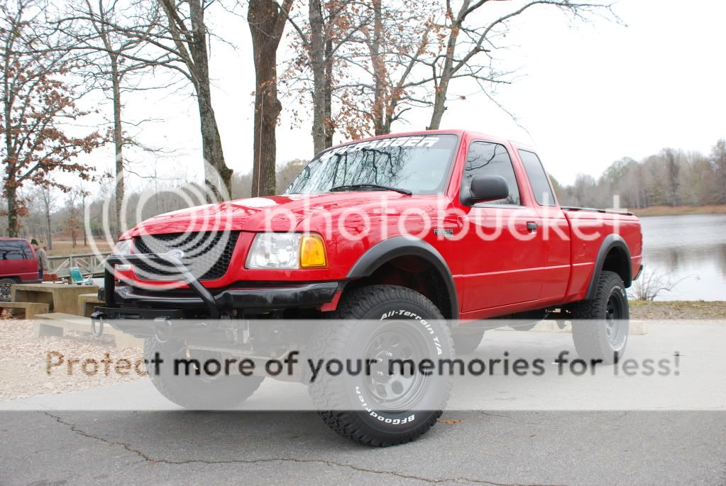

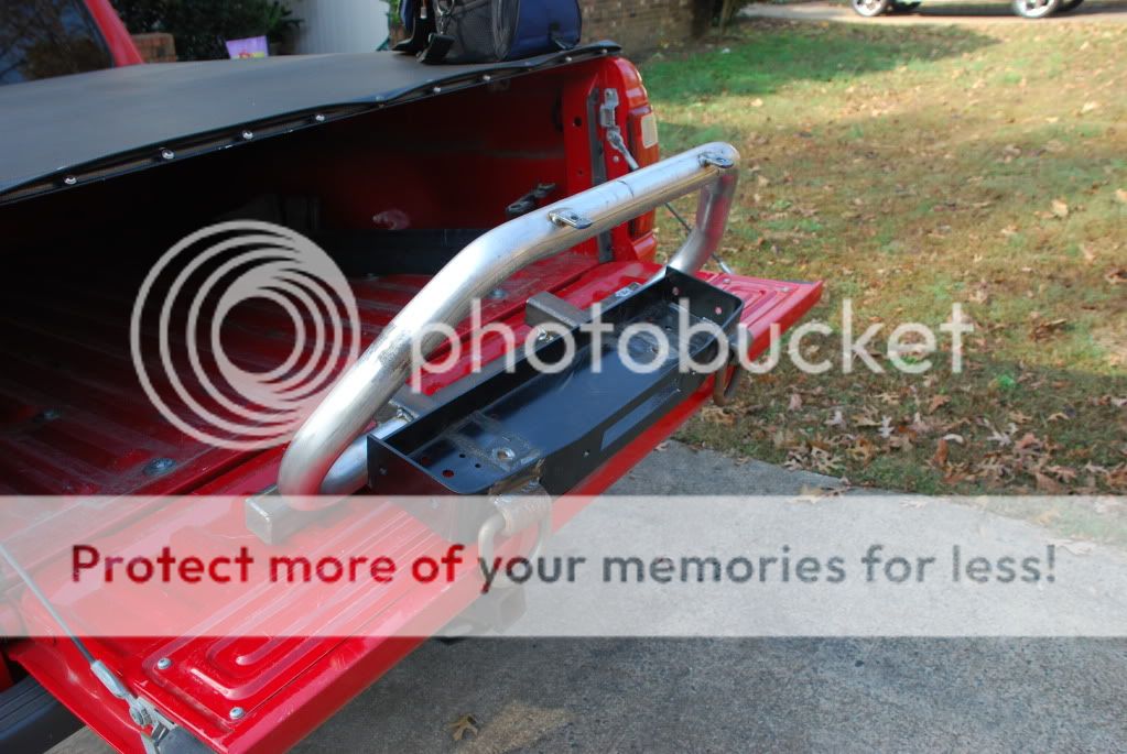

I used a WARN Universal Winch mount to mount my SmittyBilt winch to mine. Then a buddy of mine welded it to my frame. Here's a pic before powder coating.

Thanks Scotty J, thats exactly what I was needing to hear and what I was needing to see. Your truck is the same year range as mine, the front valance is already gone and steel portion of the bumper painted black, so a setup like what you did would be perfect for my '04. I appreciate the info and the pics buddy. BTW, your truck looks awesome.:icon_cheers:
Thanks man, and no problem. The welds have held up without any cracking or flaking. I've pulled a jeep, an explorer and a Nissan Versa up hills and out of harms way and it's not missed a lick. But that speaks to my buddy's welding skills and the SmittyBilt XRC8, all i did was stand on the brake and run the handset for the winch LOL.
