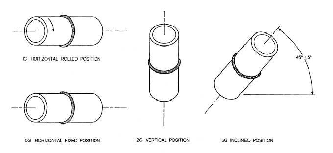

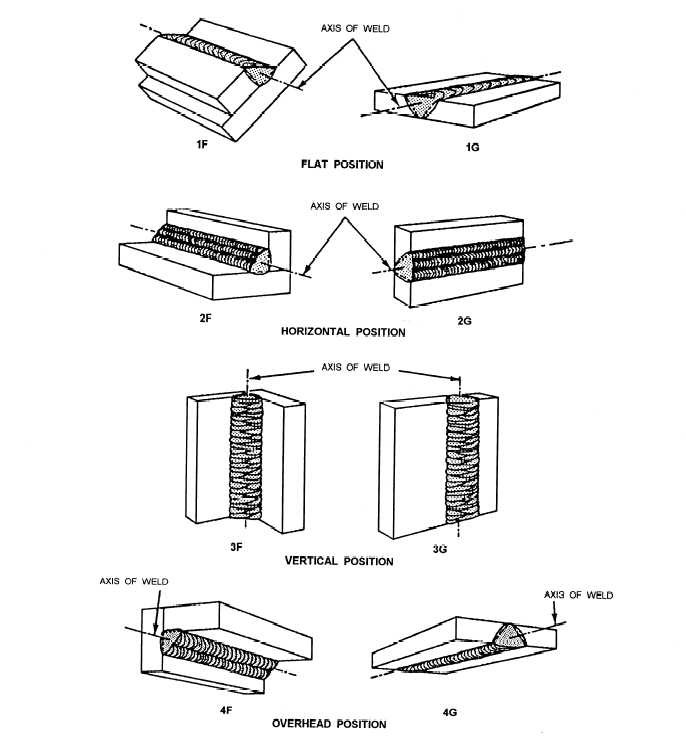

you only die if you are stupid dont be stupid...... it involves stick (Smaw) process so get a stick welder and practice. also i would practice all positions but i would assume that you would be welding 2g, 3g, 4g , and pipe positions 5g and 6 g

I'm 6G certified in TIG and Stick, so I think I'm good there:D. And I'm going to school right now for an A.S. degree in Welding Technology.
