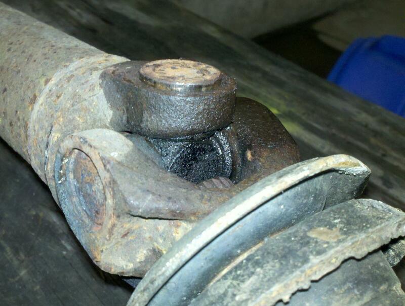

Thanks guy's but I've got all these suggestions covered already. Here is a pic with what i'm working with. The top cup is fully pressed out, the cross is now hitting the inside of the driveshaft and will not press any further. As you can see I have just barely enough to bight onto but is big time pain in the A$$ with vise grips, chanel locks, or vice. I've ran into a lot of similar situations in the past.
The cap on the side hasn't been pressed yet, that gives you an idea of how much it's been pressed already.

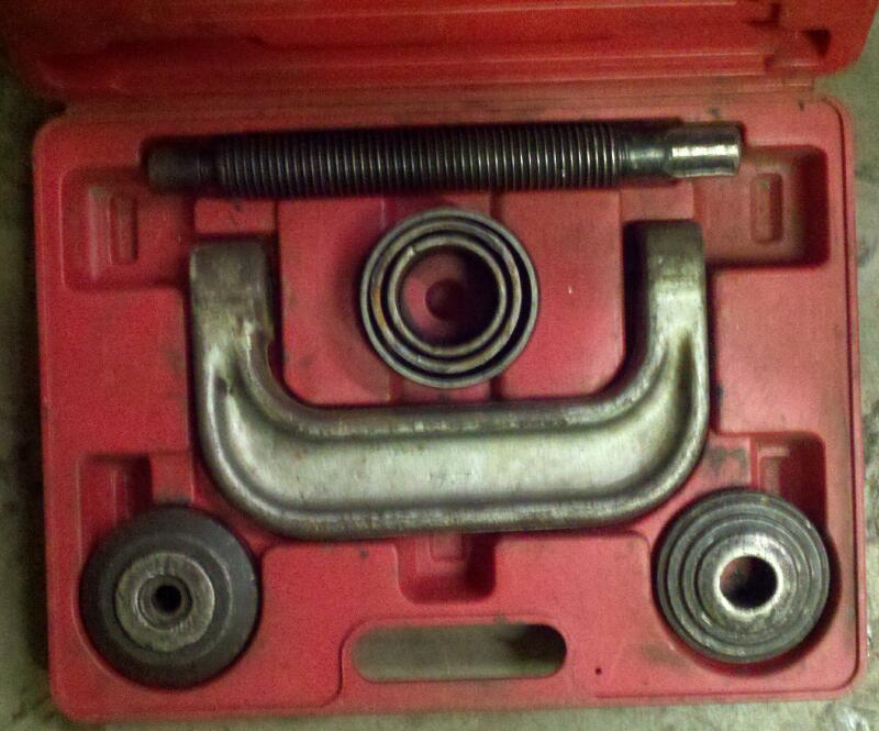

The second pic is the u-joint/ball joint pres that I used. I've been there, done that, with the c-clamp and or vise and can promise from experience this works a heck of a lot better then a c-clamp. apply pressure, whack with hammer, apply pressure, whack with hammer. Pops em right out until the cross prevents any more movement. My question is looking for tips/tricks to finish removing the cap from this point.

try using a angle grinder or sawzall to cut the cross out. once you get the cross out, just press the caps through. works like a charm.
Just had a similar experience with a double cardon front shaft. I happen to have seen a tool shown on Trucks! that looke easy enough to make. It was basically a slide hammer attached to a set of vise grips. Built something just like it and drilled the offending caps with a sheet metal screw and yanked them out with that setup. Don't have picks of it and I'm currently laid up from surgery but it was really easy to fab and worked like a champ. And I've done every other method mentioned. As a side note I personally hated trying to use my ball jpint press for this job. I don't have a vise in my garage but usually a decent hammer, large socket and a chunk of 2x4 are all I need to change out any type u-joint. Good luck!
