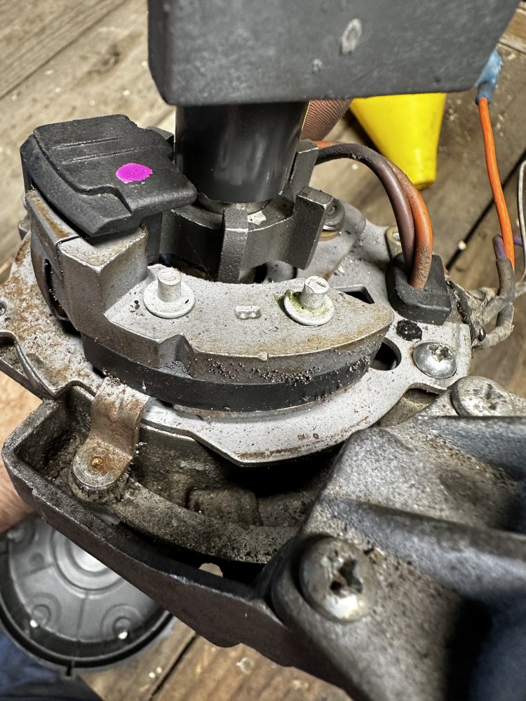

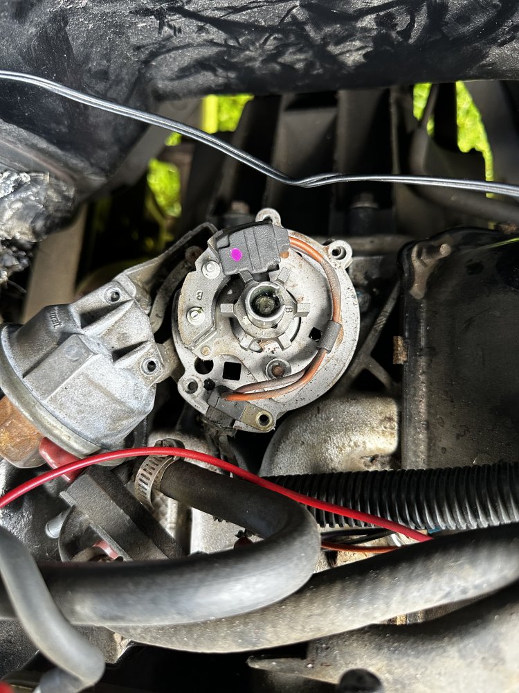

Turns over , no spark
I maybe fuzzy here...but i think you need to find a distributor/pickup from a 74 mustang ii or pinto. I believe it was the first year for the 2.8 and the only year they didnt run duraspark. 75 maybe too.

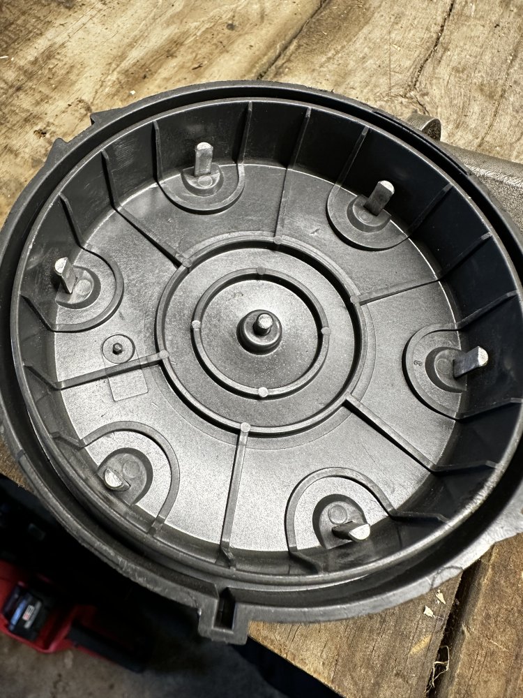

I think that you may have sanded the rotor contacts in the cap. The distributor in your picture has a pickup coil and exciter vanes, not the old-fashion type of distributor points.
Your '83 2.8 motor looks like it has been converted from the original setup, which unfortunately makes chasing replacement parts a lot more difficult for you.
If you can get a part number or a manufacturer name from the pickup that's in your distributor, you may have a better chance of tracking down a unit which will directly replace it. This is a case where an experienced parts person behind the counter at a parts store can be a life saver; or, also having the failed part in hand can make an internet search easier.
It will take some work, but I honestly think that you can find a replacement pickup for a lot less money than the full kit price.
I think I’ll try this route. I’ll get the distributor out and see if I can find any markings brands or numbers on it and take it in somewhere. This has been a headache so far and I just need my yard truck up and running again!
I will keep you fellas posted and I really do appreciate all the guidance.

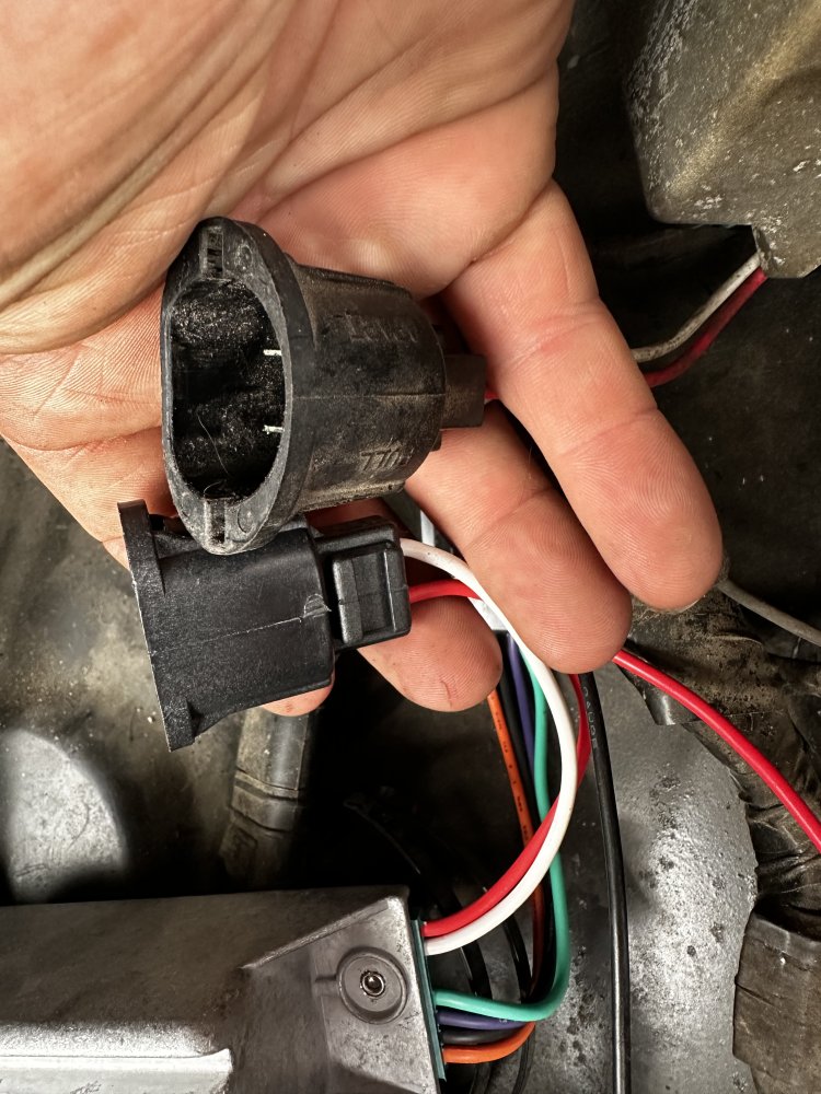

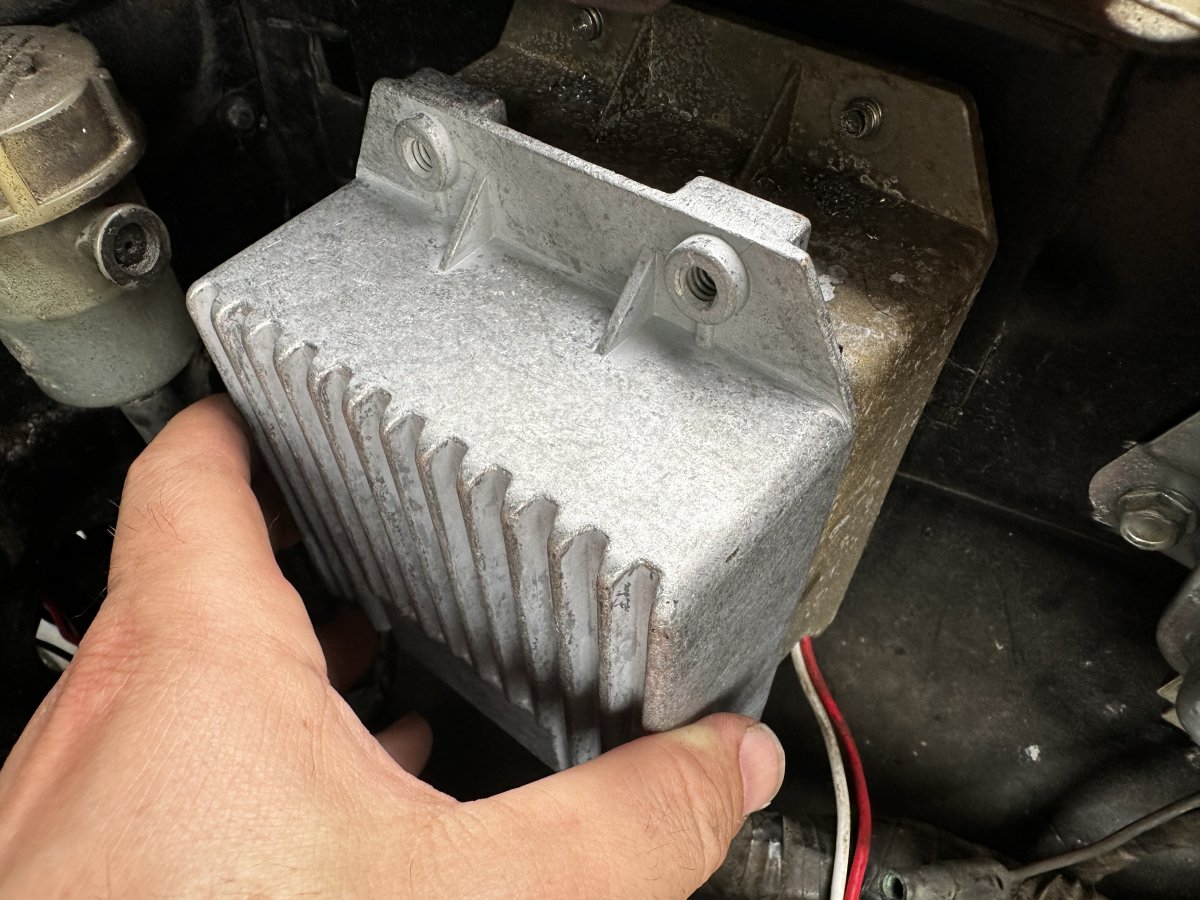

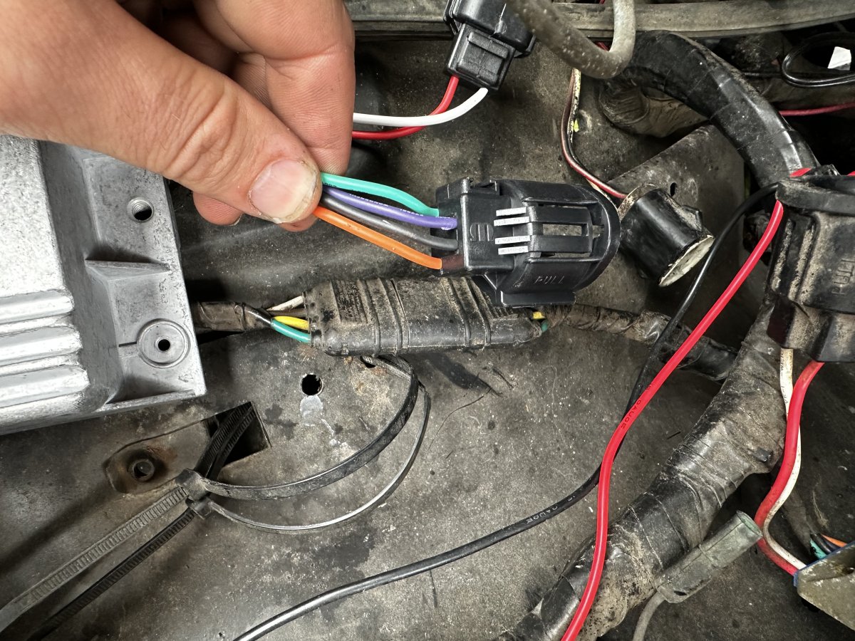

Tried the lesser of evils and went for a new ignition control module that sits on the drivers side of the truck. I figured a ~20$ part with a quick plug and play would be worth a shot in the dark. Upon further investigation the more colorful wires plugs are different. I’m not sure if this was done by the prior owner (splice job) or if the auto parts store gave me the incorrect part for the job. I’ve been to countless stores looking for this particular piece lol

You've got a (Ford) Duraspark unit. And it looks like somebody before you used a "flat 4" trailer connector set to splice the wiring back into the truck.
I would be sorely tempted to track down a good connector pigtail to restore that on the truck side. Then what you bought will directly plug in, and also will in the future if it needs replacing.
I was thinking that could have been the case! Thank you I will track that down in the mean time

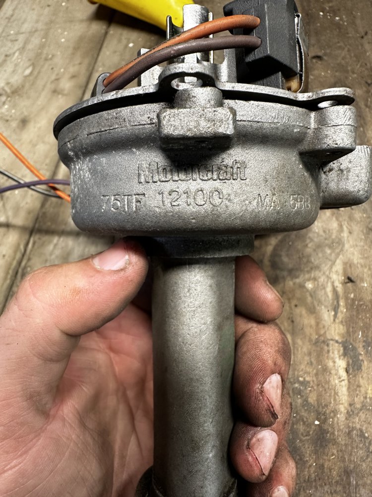

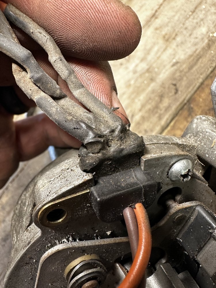

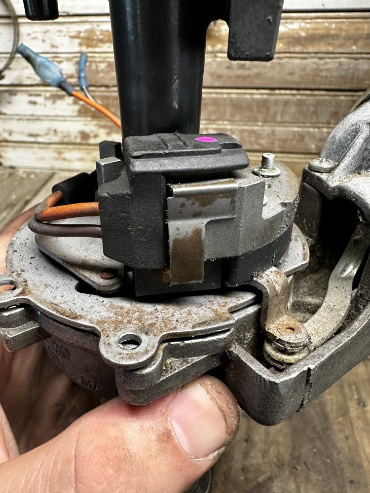

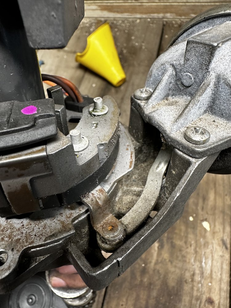

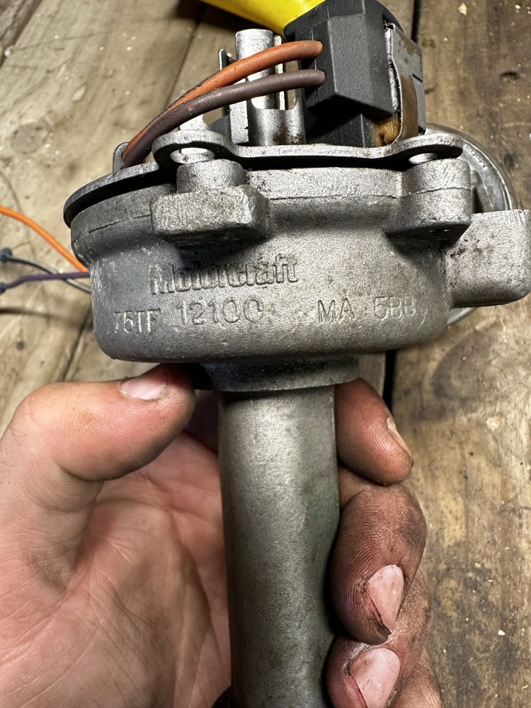

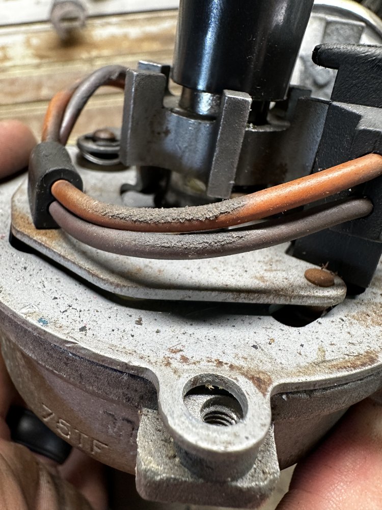

Distributer is pulled. Appears to be reman’d. Wires don’t look the cleanest and appear that they’ve gotten some heat at some point.

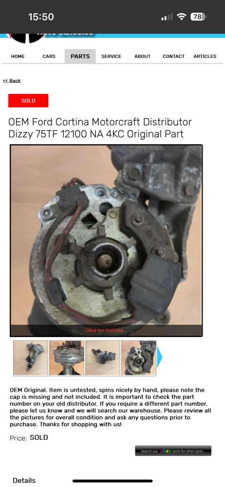

After looking at the part number it seems that this part is from a ford cortina. Could be wrong but they look identical.

I have had a Duraspark module fail before, but haven't had a pickup failure. You could always try getting your new module in before buying more parts.

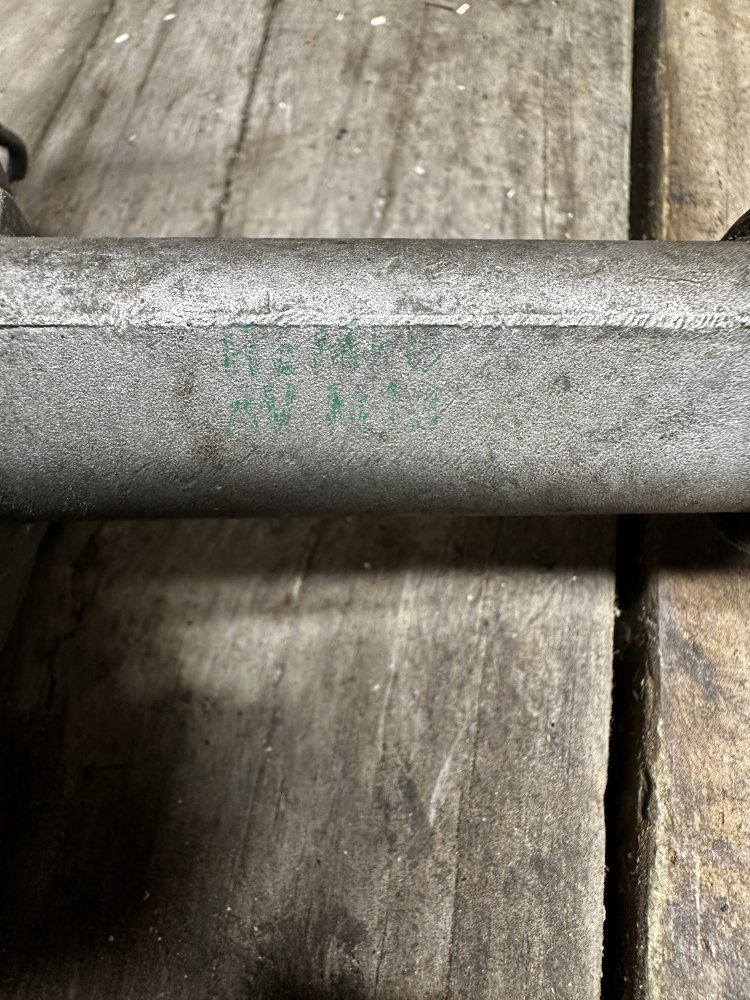

Pic 5 looks like wires have been repaired and heat shrink used over repair. Or maybe wires are actually broken under insulation. Take a really close look at that.

Cleaned the dizzy and gave it a good look over. Took it to work and gave it a cleaning.
ended up picking up a new coil for about 35$ (decent brand). Plugged it in and dropped the dizzy in to see if it would sputter and it did!
not sure if it was a combo of things but I’m just happy it has some life back. Now I’m in the process of trying to figure out how to time the damn thing but progress is progress none the less and now I have some new spare parts to help me future proof the rig.

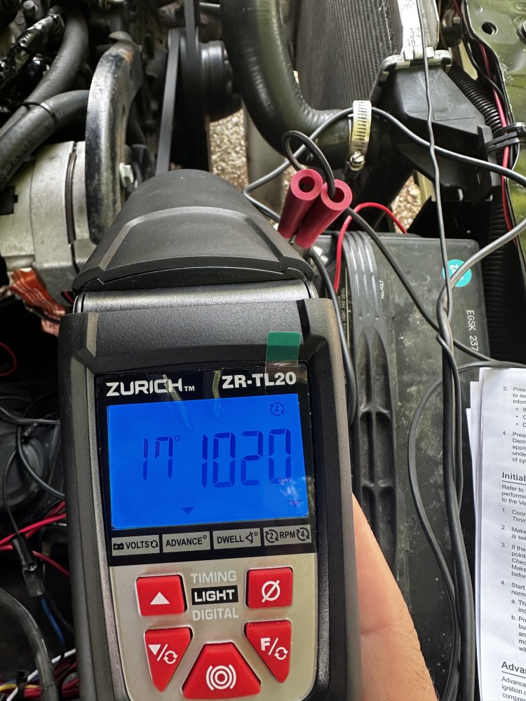

Got the ranger running at around 10 degrees but it kept dying while idling and some backfire while driving.
Adjusted the dizzy and now it’s idling faster than normal (I’m assuming it’s around 800 rpm) I’m at 990-1000 rpm and the exhaust tones aren’t as loud as it was prior. However it’s driving great!
should I try to retard the dizzy? I’m at 17 degrees which seems kind of far (and sounds a bit fast) but again other than it being more quiet on the exhaust and it idling faster the preformance is great again but i miss those exhaust rumbles.
where should it be at rpm wise at idle? I don’t want to play with the carb if it’s the dizzy that I messed up lol
