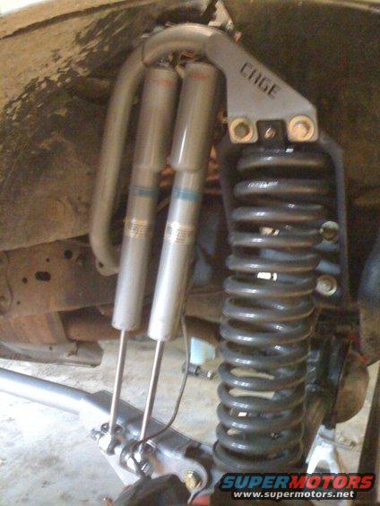

Well over all the JD arms are alot stronger build. They weight alot more then the Skyjacker arms do. I have had a SJ Class 2 under my truck for 12+years. I just swapped in JD stuff and over all I would say the JD stuff is beefier over all. I am sorry I failed to throw the JD arm on a scale before installing it but I do have side by side pics of the 2 arms. Also the JD arm seems to run inside the edge of the frame rail right up until it curves to connect to the Traction Beam. I really like the dual shock mount on the front end as well. With the JD stuff and a Dropped Pitman Arm my steering linkage is setting pretty damn close to the stock set up versus the amount of drop I had with the Sky Jacker. So far I have noticed a reduction in bump steer from that alone versus my skyjacker.
Do not take what I am saying the wrong way I am not against Sky Jacker in any way my kit served me very well for 12+ years. I never had any breakage issues with it.
The JD system also runs a variable rate spring which should improve the on raod manners of my truck over the Sky Jacker.
All in all both seem to be very high quality kits I am just liking the the JD over all more then the Skyjacker that has served me so well for so long and the added wow factor is the Kick Ass Ford Blue they chose to put on the parts.
