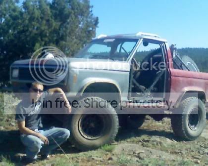

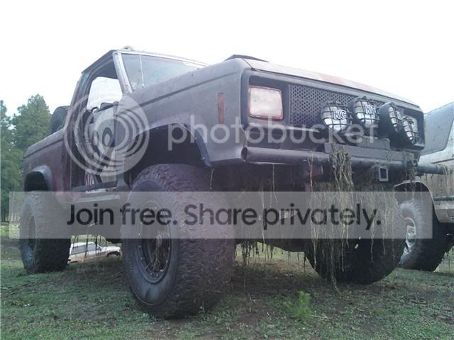

Mine
I like half doors better too... again just my $.02. Here's mine if you're interested.

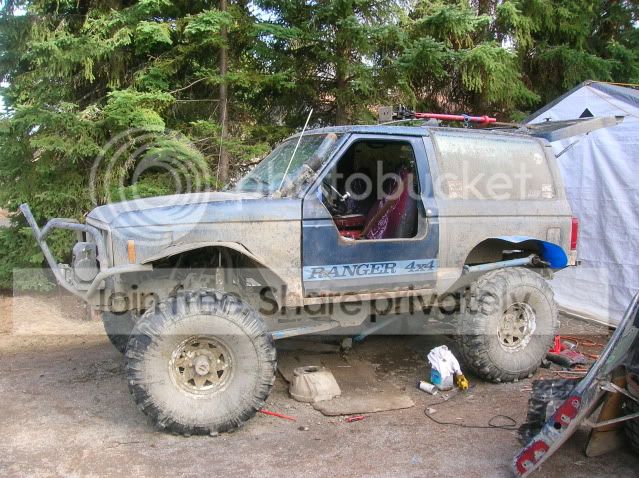

here is mine. kinda ugly, but they work. build them in a day with a 110 wire feed. and 32 dollars of scrap steel, junk yard hinges, and barn door latch's.

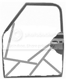

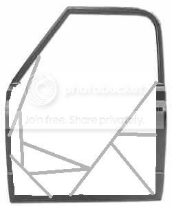

i've seen the discussion thousands of times, the biggest thing you should remember, doors add a lot of rigidity to the truck, without doors, the frame and body will flex much more... so what i would do is make a half door, and fill in the bottom half with tubes... i made these pics a while ago...

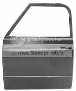

start with a full door

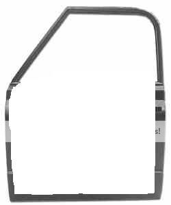

remove the center of it, leaving the outer part intact, the part that's going to press up against the frame, and give some rigidity...

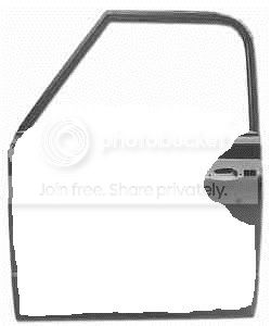

with all that gone, this door is going to be strong in some aspects, but still be rather flimsy... so i would add in some tubes in a manner like this... depending on how many tubes you put, you can use larger or smaller tubing...

See I thought of doing that under the outer skin! That way I have tube doors on the inside and looks like half doors on the outside, and somehow keeping the factory latch and release handle on the inside. Shaved handle on the outside.
the way i would do it, i would do a hybrid between them, i would take a set of newer jy doors, because the latches in them are all in 1, it's all incorporated into one little module, and from the outer handle to the module is a rod about 4 inches long, if that... i would trim the door, as much as possible to leave the handle still there... kinda like this:
i would fill it in, like andres has, then start building your cage deal...
