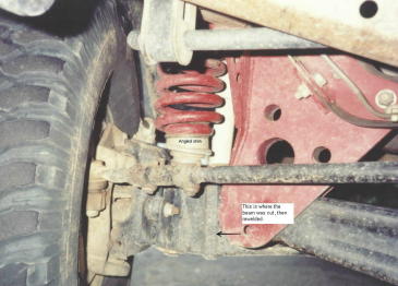

I got a ttb 150 for the outer knuckles to do the swap onto my 91 ranger, however I was looking at shortcuts (of course lol) and thinking, since people weld on the arms to plate or gusset the weak points, why not just cut the complete 150 arm down to ranger size and weld it back up with reinforcements? Since this is an off road only truck anyway...
I thought of how much taper they have and how to make up for it, so, I measured the length of the 91 ranger and the 95 150 drivers side arm.
Uhhhhh, they are both 37-38" from pivot bolt to inside of "C"!!!!!
Now I was only measuring on one knee because I was in good clothes and the wife was waiting in the car, but it looks like the 150 has less overlap between the pivot points and that's how the 150 gets its wider track than the ranger.
So, how come everyone is swapping knuckles instead of complete arms? (When I have time to measure and think it might be apparent, but having an epiphany just before going out is maddening!!!! Lol.

Hold up.... that will not work. The D35 center section will NOT bolt onto the D44 beam. If you want D44 parts, you either swap the whole thing, do a knuckle swap onto your D35 or a spindle swap onto your D35.
Yeah. Read the articles that @85_Ranger4x4 linked. This stuff is documented. You don't have to guess and reinvent it.

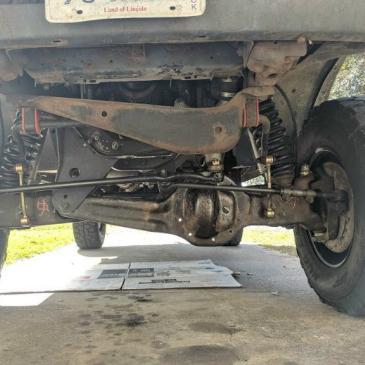

Wow! Thanks for all the info guys, after looking at everything and deciding what my needs are this is what I come up with.
Bad
The 44 I have is 3.08 gears
The complete swap will result in a wider track that I don't want
The front axle will have a 5x5 bolt pattern and will require new rims and rear axle swap
Good
Stronger ball joints
Better/stronger hubs and locks
Bigger brakes
But what do I NEED?
I need a stronger hub lock
Bigger spindle/bearing placement for strength with 35's
What I don't need?
Stronger ball joints (no issues or smashing/crashing that would warrant a stronger joint)
Stronger diff (35 is plenty strong for my low speed off roading)
Bigger brakes (only go off road in low range)
So, I think what is best for me is to replace the spindles and turn down the disc.
On the back I'll see if I have to swap in my early bronco 9" or drill the existing flanges for the bigger bolt pattern.
Thanks everyone for the links and info/replies!
