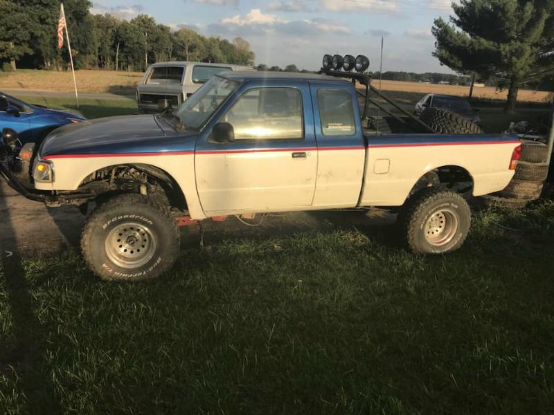

For those that haven't seen this posted on facebook, my last Ford Ranger (TRS-2) is for sale on facebook Marketplace, and I have been in touch with the seller to try and buy it back.
The Ranger is in Shelburn Indiana (southern Indiana) , which is almost 900 miles from where I am in Texas.
The transmission is out of the Ranger, and it has a broken right / front axle.
The only person I can think of in southern Indiana to ask to go look at it for me is Will, but I haven't been able to make contact with him yet. The Ranger would need towed someplace and fixed.
Fastpakr and I discussed the possibility of me buying the Ranger back, hauling it somewhere and storing it for a while, and then finding a group of people that would be willing to get together for a weekend, and wrench on it.
Since I built the Ranger in 2004, I think I (we) need to:
  • Inspect the frame for cracks, since I don't know what it's been subjected to since I owned it.
  • Inspect all of the suspension components for cracks or damage.
  • Inspect the gears and differentials. Clean and refill with new gear oil.
  • Inspect and replace any bad radius arm or TTB pivot bushings.
  • Replace the broken front axle, and all of the u-joints.
  • New shocks.
  • New brakes.
  • Oil & filter change. Inspect fluids for possible signs of engine damage
  • Flush radiator.
  • Install new transmission with an additional transmission cooler.
But first, it's going to have to be looked over and purchased if it looks salvageable.
I know from photos that the tires are dry rotted, and will need replaced.
Once it's in good sound mechanical condition, emphasis will be put in to giving it a fresh new 'TRS' look.
