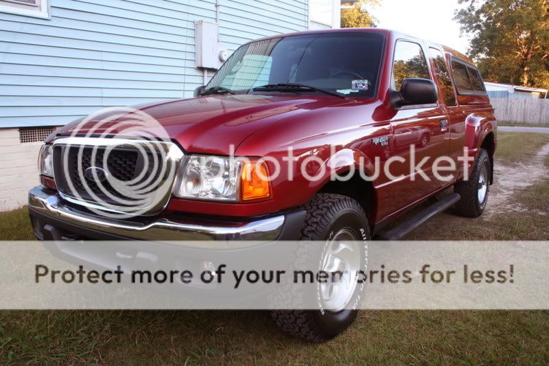

i cant really help you with the question but that is a VERY nice ranger you have there. so clean you could almost get away with saying it has never been driven

Man, that thing is unbelievable!

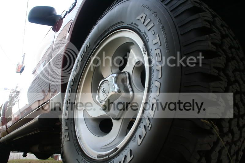

Those rims came on an exploder, not a ranger from the factory and they're probably 15"? (I think I see 15 in the last picture on the sidewall) I'm almost positive that truck came from the factory with 16's. That would speed the speedometer up 5 MPH guaranteed. Doesn't really matter how it got screwed up, the fix is no big deal- a PCM reprogram telling it the rears and tire size. It won't fix the mileage showing on the clock, but it will straighten out the speedometer.
I don't think you'll have any problem selling that truck if someone can just get a look at it before they see the odometer!
What is the tire size on the door, should be something like 265/75R16 or something similar to that... at least that format. I'm almost certain that 31" tires came stock, and not 30"s.
Well, you guys are right about the wheels. I had the tires and wheels on my Explorer, and switched. The overall tire size is the same though.
