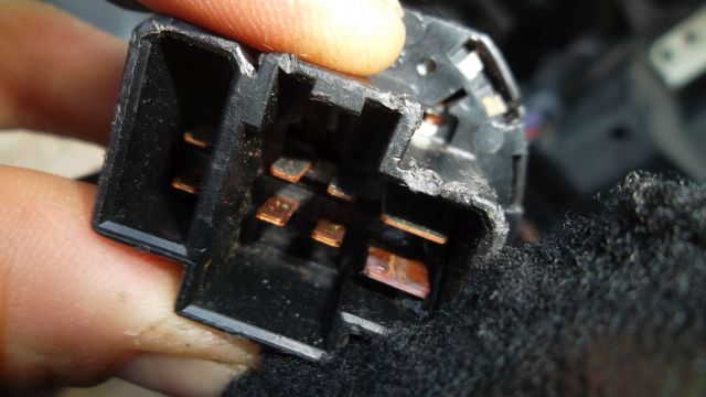

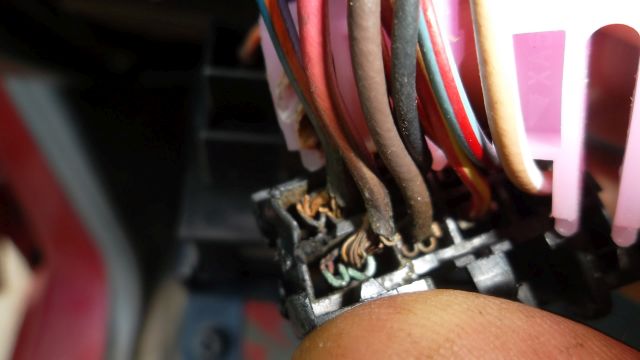

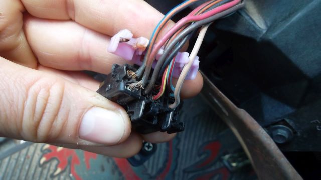

Before I replace the headlight switch for the second time, I'd like to know how to determine exactly what keeps frying/melting them. The excessive heat seems to be limited to the larger two of the eight prongs on the switch itself, along with the terminals they slide into in the electrical connector. The heat damage is easier to see in the pics of the wires/connector than it is in the pics of the switch, but it's apparent on both parts.

First off your problem is that the connector needs to be replaced. The wires should not be exposed in the plug. You are getting a short or arc when the headlights are turned on and is causing the problem.
http://www.rockauto.com/catalog/moreinfo.php?pk=3969945&cc=1138148&jnid=689&jpid=0
They are about $25.00

Thank you for your prompt reply, I haven't been able to find that part anywhere until now. Is it likely that that connector and the switch itself are the only components in need of replacement to prevent future burning out of headlight switches? If so, I'll be changing them out immediately.
