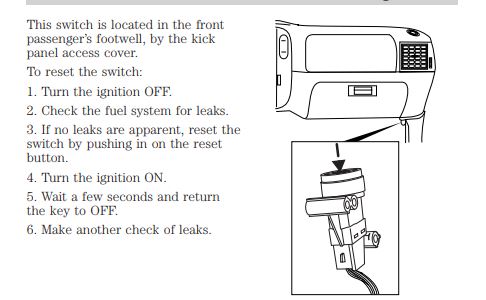

Check your fuel pump interrupt switch
+1 ^^^
Inertia switch
Agreed.
