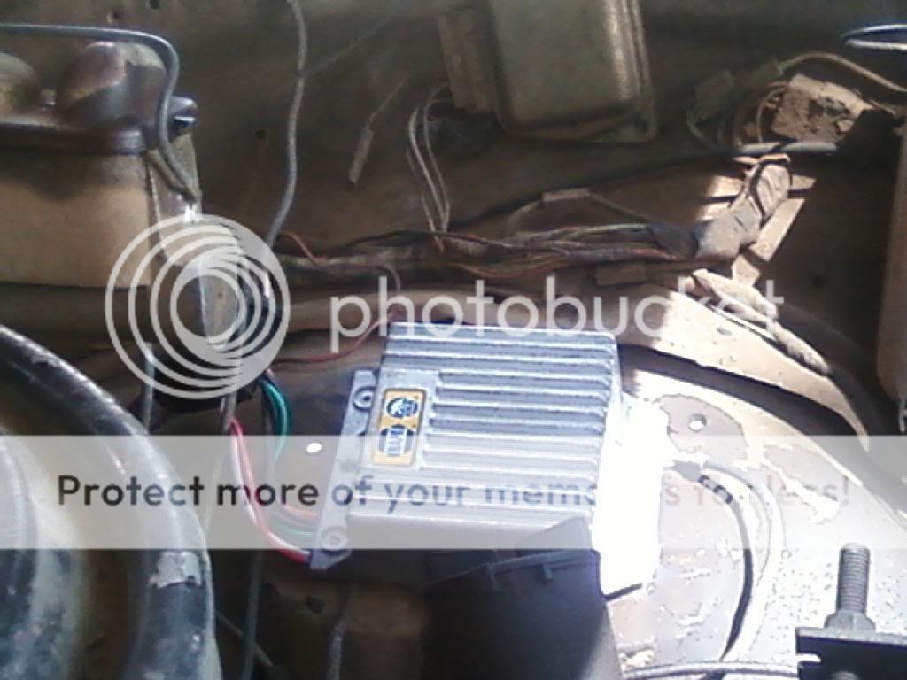

So pops finally decided we would change the D/spark control module, TA DA...
I had that beast up to 6k on the tach with no sputtering and she starts right up!!!! :yahoo:
Here's my new module, from Napa of course...

Thanks for telling us what happened. That is new to me in as much as I have always found the module is either all good or it fails.
I'm still learning.
Could be a heat related problem in those modules. Heat can do some weird things to electronics. Even heat build up under the hood just from sitting in the sun can do weird things, especially on these old vehicles. Kind of like the ignition module on the back of the distributors getting old, then getting hot and shutting the truck down, sadly a friend of mine had an 84 B2 in high school that did that, didn't know back then about those modules so instead of trying to track down the problem he had it hauled to the grave yard.
Well, it was definitely the problem. I didn't start it for 2 days and it has been raining, got in it today and it started 1st try!! :yahoo:
