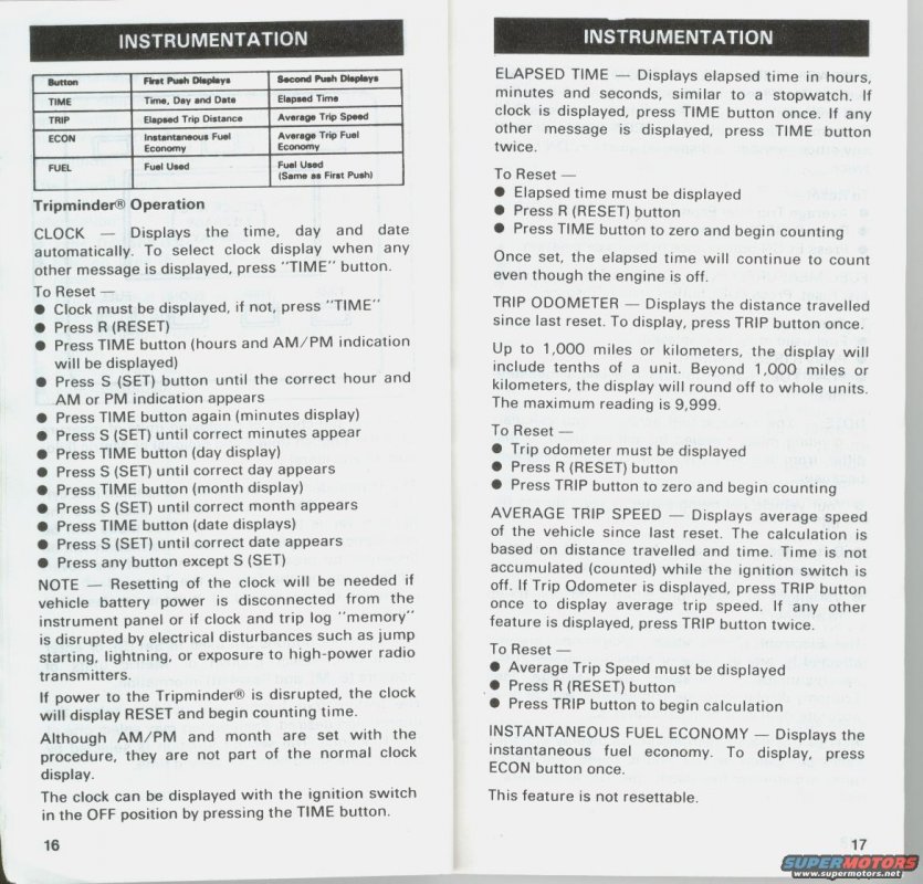

Okay, this is a dumb question, but does anyone know how to set the clock/calendar on a tripminder from a mid 80's Crown Victoria?
I installed one in my 89 Ranger, and can't figure it out... I would also like to know how to reset the digital tripometer...

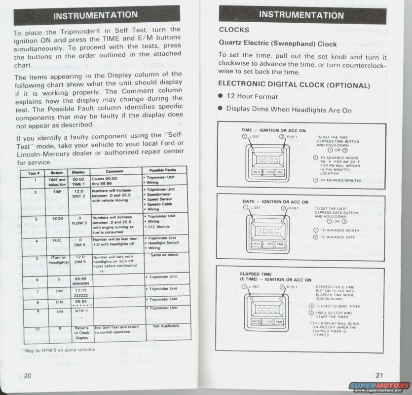

Not 100% sure but...
IIRC hold the time button while also pressing the "S" button to set the hour and the "R" button to do minutes.
I think.
I think.

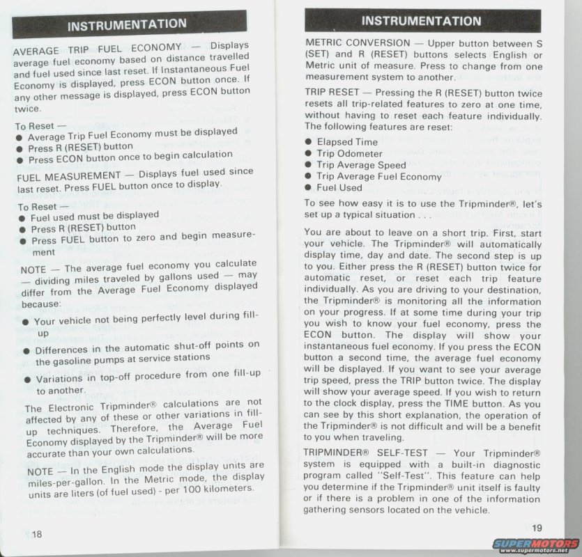

Lifted from crownvic.net....
