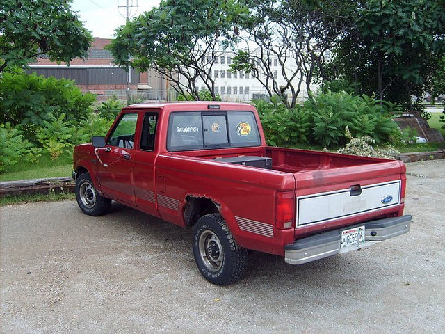

I'm thinking about doing the same thing. Mine has rusted out around the top of the wheel arch in the back. I'm gonna use my 4 1/2" grinder with a cutting wheel to do it.
