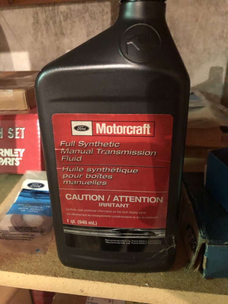

There is a TSB recommending this to eliminate notchy shifting on a TK-5. I’m presently running Red Line MT-90 in mine. I think the original spec was for 80 or 90 weight gear oil, which I could never find.
In my experience, conventional gear oil caused difficult shifting in cold temperatures, and I was concerned about additives reacting with the brass synchros.
