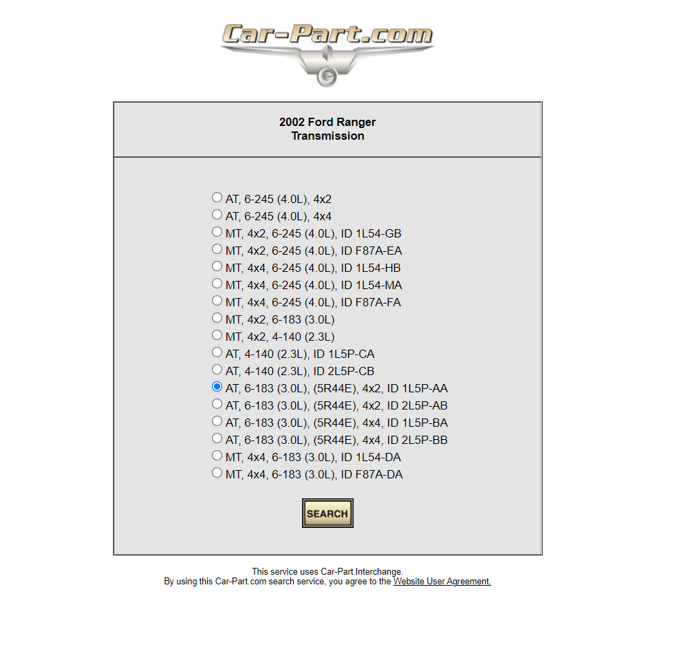

Do you have any thoughts as to why when you look for these on Hollander Parts or Car-Part.com they give you two options for transmissions for 3.0l 2wd ?
Do you know what the difference is between the 1L5P-AA and the 2L5P-AB?

No, not sure why the difference, only Ford would know specifically
But not really important unless you will be rebuilding the transmission
So doesn't really matter to your swap, Ranger/B3000 3.0l 2WD Automatic is what you need
Ford Part numbers starting in 1999 use the first digit for Year, 2nd and 3rd are vehicle model, Ranger is L5, 4th is Department in charge of this part, P = Transmission and Axle Products
1 L5 P would be 2001 Ranger transmission(or axle)
2 L5 P would be 2002 Ranger transmission(or axle)
BUT...................
The year of the part is not specific to the year of the vehicle it is used in
2L5P might be found in a 2008 Ranger if there were no major changes in this part thru 2008, so its the year of the design only, the first year the part was in production, not the only year it was used
So evidently there was enough of a change between 2001 and 2002 to update the part number's year, this was most likely an internal change, so when ordering rebuild parts you would use the 2L5P number if that is whats on the transmission
X L5 P would be 1999
Y L5 P would be 2000
Just FYI
The last two digits, suffix, are revisions, so not major change just updates, usually first model is AA, then update AB, then AC, ect
But to recognize earlier updates to earlier part numbers of the same basic part, it could start at CA, then CB, can even skip to CD
But a Suffix can also be specific, i.e. left or right mirror will have same part number but A is right side and B is left side or visa versa
Again, when ordering internal replacement parts also using the suffix can matter
Ford has a record of what all this means but they do not share it, lol
