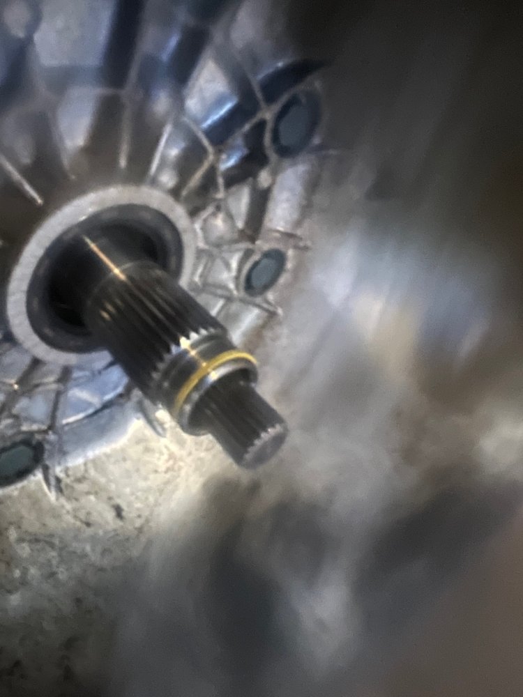

I think that I know what is causing my lockup issues.
I pulled the converter off the old transmission when I was moving it out of the garage and I noticed that there was a yellow teflon ring on a groove in the shaft. I'm pretty sure that there wasn't one in the groove on the donor transmission.
Any thoughts on the implications of driving without this part? Should I just turn off lockup in the code until I can fix it?
Thanks
Chris

Yes that could be the problem
Try part number F77Z-7L323-AA
Thats a 1997 part number(F7) so should be good up thru 2000 or even 2011
I also see a 2003 number: 3L2Z-7L323-AA

3L2Z-7L323-AA Looks different than the one that is on my old transmission. I think that it is a continuous ring and requires a special tool to get it on the shaft.
The one on on my old transmission looks like this
Would F7TZ-7L323-AA work? This is a split type but I cant find any info on it.
Thanks Ron.
No, that O ring is not the proper converter shaft seal, the replacement is a teflon O ring, the ring is *square*, it is a complete circle, it has to be lubed, then carefully pushed onto the converter input shaft into the recess.
That ring seals the oil into the converter internals & prevents leaking into the converter housing.
Steve,
So you are saying that it is the first link at Tasca, correct? This will slide on without any special tools?
The one that was on my old transmission is split and looks just like the second link PN 56178AT.
Thanks
I can't speak to the Tasca parts identification, when I had the trans out 4 yrs ago to replace the converter which suffered a lockup failure due to the shaft bearing the disc rides on I had to replace that same input shaft seal.
It's a common part to the 4r44e, 5r44e, I just picked one up at the local AAMCO trans shop, they had a stock of them.
