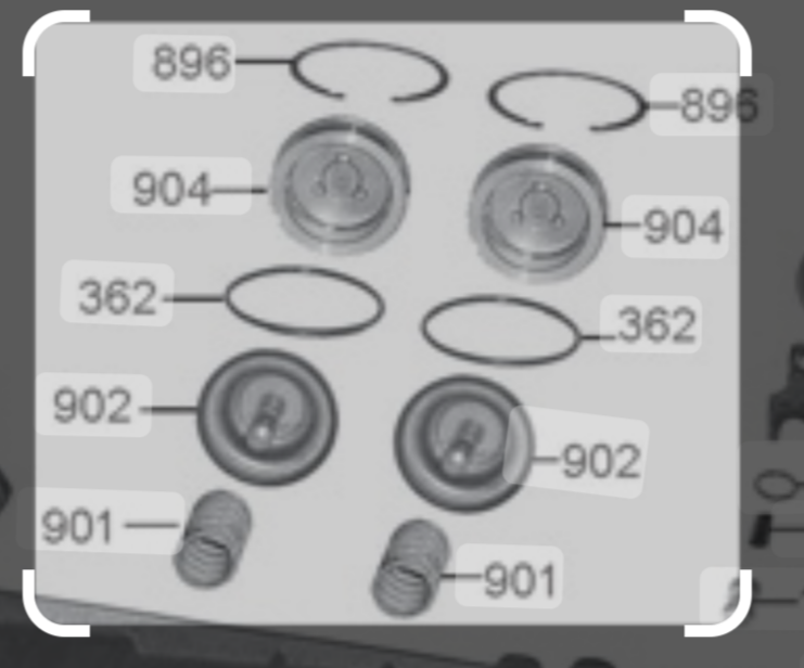

Trans is dumping fluid from the front round ,(looks like a housing) with a retainer clip holding them in the front one ,the retainer clip is about half off and fluid comes out fast than I can fill it when running. I can fill it up and still goes in gear drives fine but I don't want to run it dry on fluid.
I need to know what those 2 round units are and how to repair or replace without dropping trans

the band servos the front one in the overdrive the rear one is the interment. there's a tool to get them out not needed to replace them but helps a lot.
Cool thanks I finally found the name but wasn't sure I was correct overdrive servo ,and intermediate servo .if I do 1 might as well do both I'll look up that tool 👍any other suggestions sir?
Damn it just figured they ain't cheap 🤣 hell I can make one with a lil plate and bolt I'ma have to watch you tube my truck has over 300 k and never been opened if I hadn't been driving it like I stole it out in a field probably wouldn't be here lol
they come in different sizes too. there's a two litter code on them like AA, AB, or ZA there's more codes. you can read them while the covers are in the transmission may have to remove the cat.
had one of those covers crack on the 2000. sprayed fluid all over the pass side.
part 904 in the pic.
