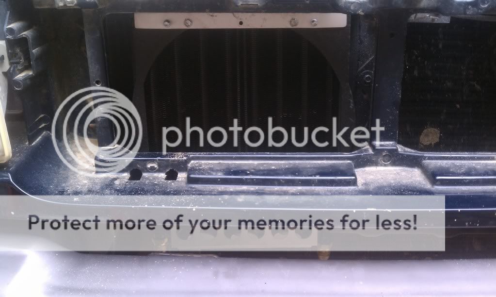

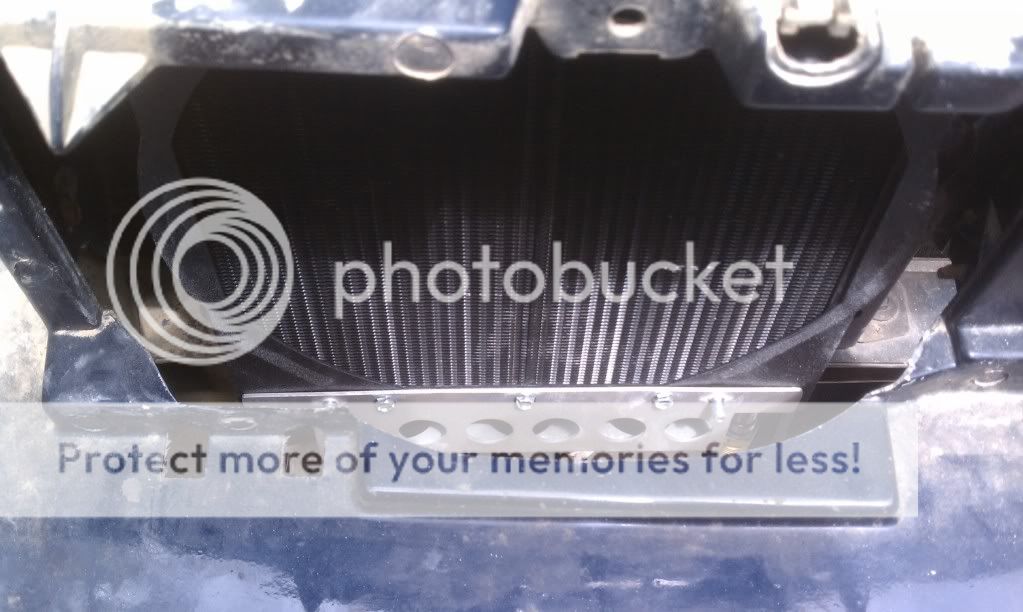

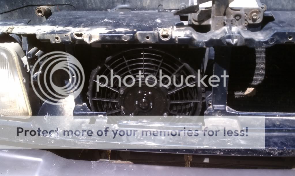

So I had my transmission rebuilt this will be the 4th transmission Haha. So this time I'm gona do some things to hopefully make this one last and hold up to wheeling better. I ordered a temp gauge and cooler from summit the cooler was a lil to big I made it fit but had to do some triming. I wanted one with a fan for wheeling because of minimal air flow at slow speeds.

The fan came with a 175 temp switch but I had the trans at 200 today and no fan. The gauge I got has a built in output so I may use that instead

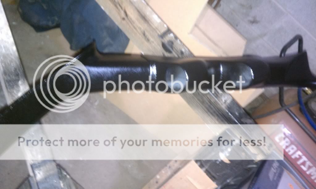

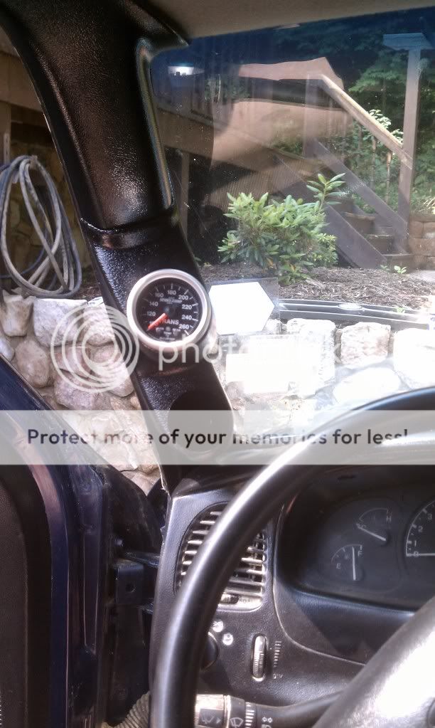

I got the double piller pod don't know what other gauge I'm going to install but I'm sure there will b something sometime.

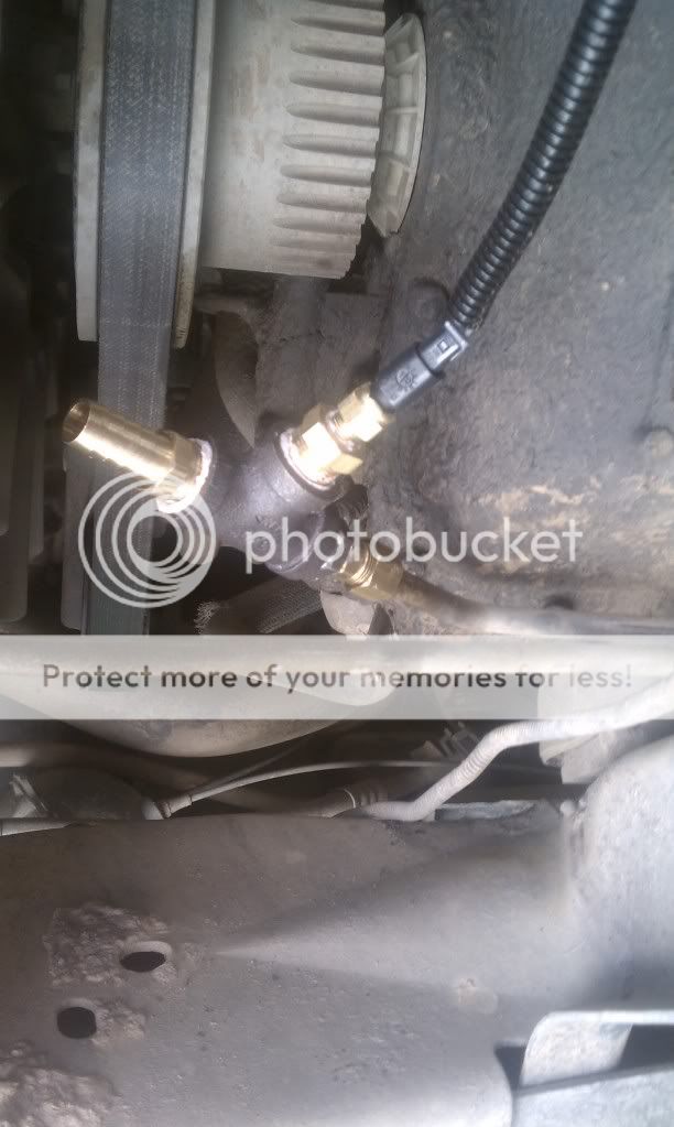

I installed the gauge on the output line of the transmission and I plumed the cooler in before the radiator. I did a lot of research and it seems like ppl do it both ways. I did it this way so in the winter its not over cooling the transmission.

Im no expert on this, as I am also in the process of installing a tranny cooler on my 90 B2, however from the looks of your pics it looks like you have the lines going into your cooler from the bottom. I think they are supposed to go in through the top that way the fluid has to pass all the way through the cooler before being routed back to the tranny. The way you have it it will just go into and right out of the cooler. I think.
