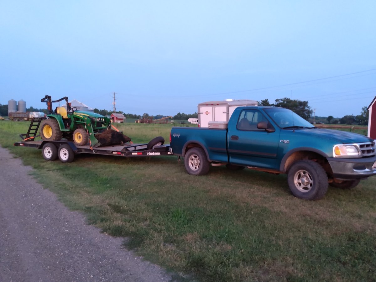

I have a 2008 Ford Explorer with the 4.6L V8 in it, and been thinking about getting an older F150 late 90's to 2008-10 to use to tow my 18 foot car trailer when I need to haul my tractor and implements around. Does your F150 have any issues pulling your setup? Your JD is bigger than my BX2680 so if you don't have any trouble with your setup the F150 would be fine with my smaller tractor/trailer.
I would think you would be fine towing that with your explorer. Especially if it’s only a couple times a year.
I have a 18’ trailer I tow occasionally tow with my ranger. About 2k lbs of trailer plus 2k of tractor is no problem.
The Hudson trailer I have was lengthened 2' when I ordered it and it seems they didn't add it and adjust axle position. All in all it fish tails a lot because they didn't move the axle position back... With the right trailer it would be 100% fine. But I had to choke the tractor up on the trailer to prevent the fish tailing. Also I think these trucks need about .5% lower reduction on each gear 1st and reverse are way too low of a ratio and cause a lot of foot work. Just my opinion of the trans...

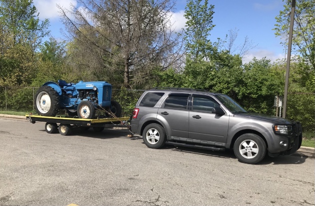

A tractor that small you “might” be able to pull on a trailer with a ranger , I brought my 63 ford 2000 home on a small tandem axle trailer with a V6 escape 50+ miles from home with no issues. I did try using my ranger once to tow it to a small show, was way too much for mine, wouldnt want to do it again.
