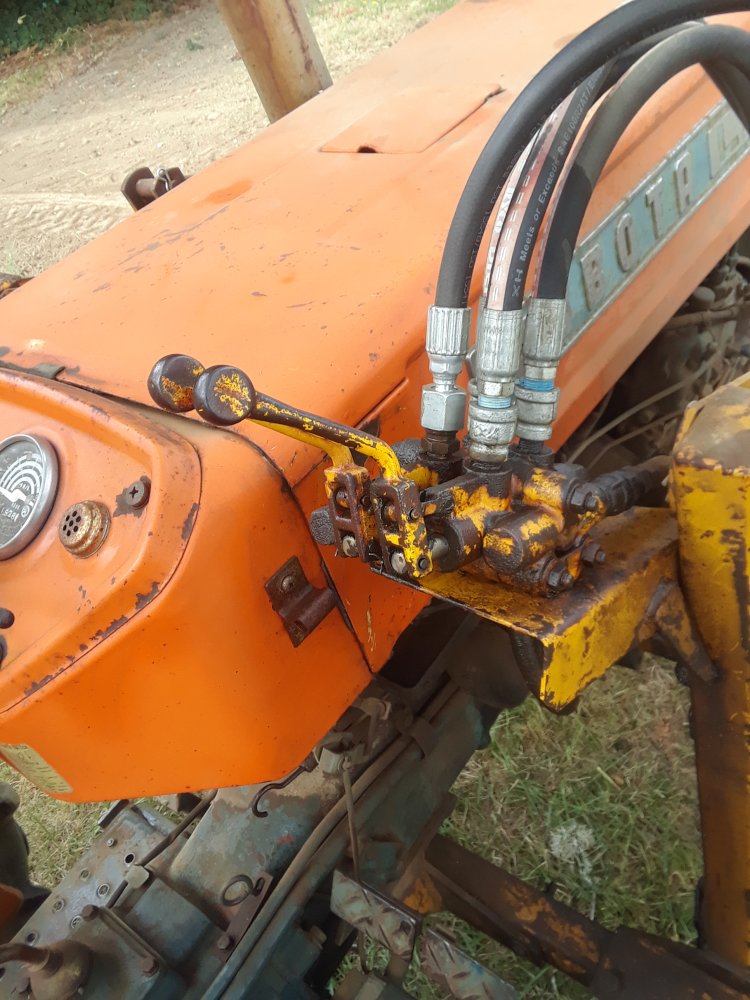

The janky old valve is a no name from the '80's, I'm pretty sure I could reseal it but the bores for the spools are likely shot, it's nothing special... I'll take an inventory of the type of fittings that's on it right now but I think everything is NPT... I did some looking and didn't see any 2 spool with NPT fittings but there is a 3 spool which would open up to a hydraulic top link or a remote for something (or grapple...) for like $76 shipped straight from Vevor... we shall see... options...

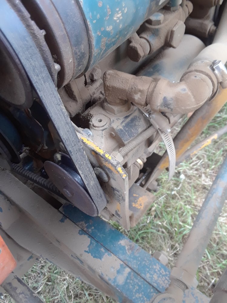

Just realized I took a pic of my old janky valve a few years ago the first time I was thinking of looking for a replacement... also a pic of the JANKY external pump mount on the side of the engine... I've mildly reworked it a little over the years, one of these times I'll add a flat idler to get some more belt wrap somewhere since it slips, that's my current over pressure relief...

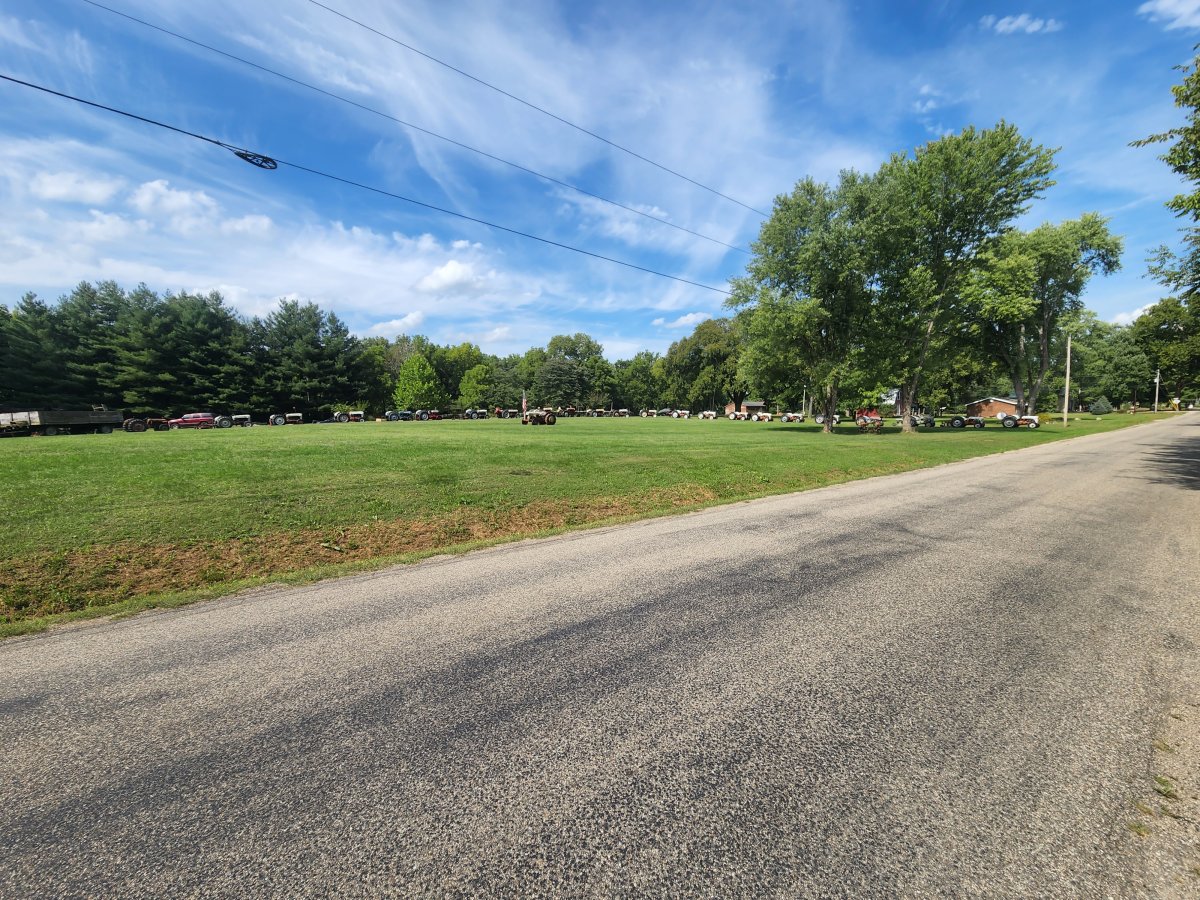

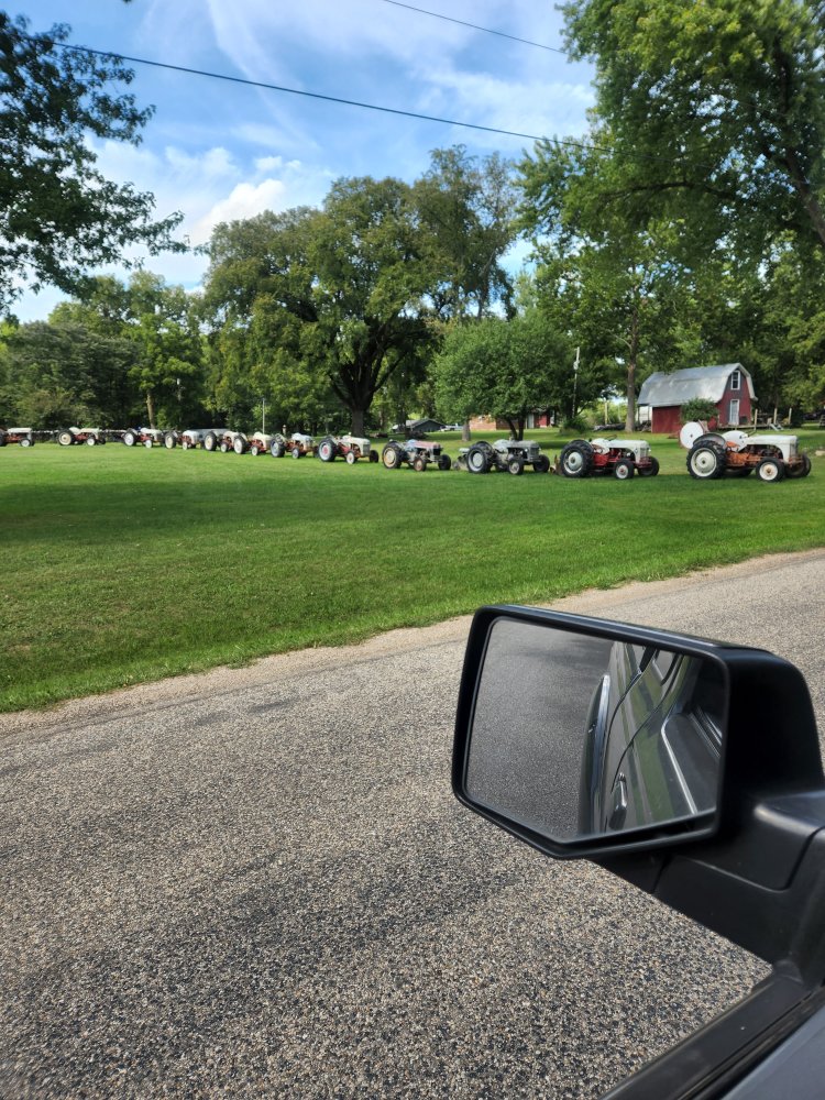

Thats a lot of N-series there! mostly ‘8’s.
Those tractors were sitting in the same place two years ago. I believe they're yard art.
