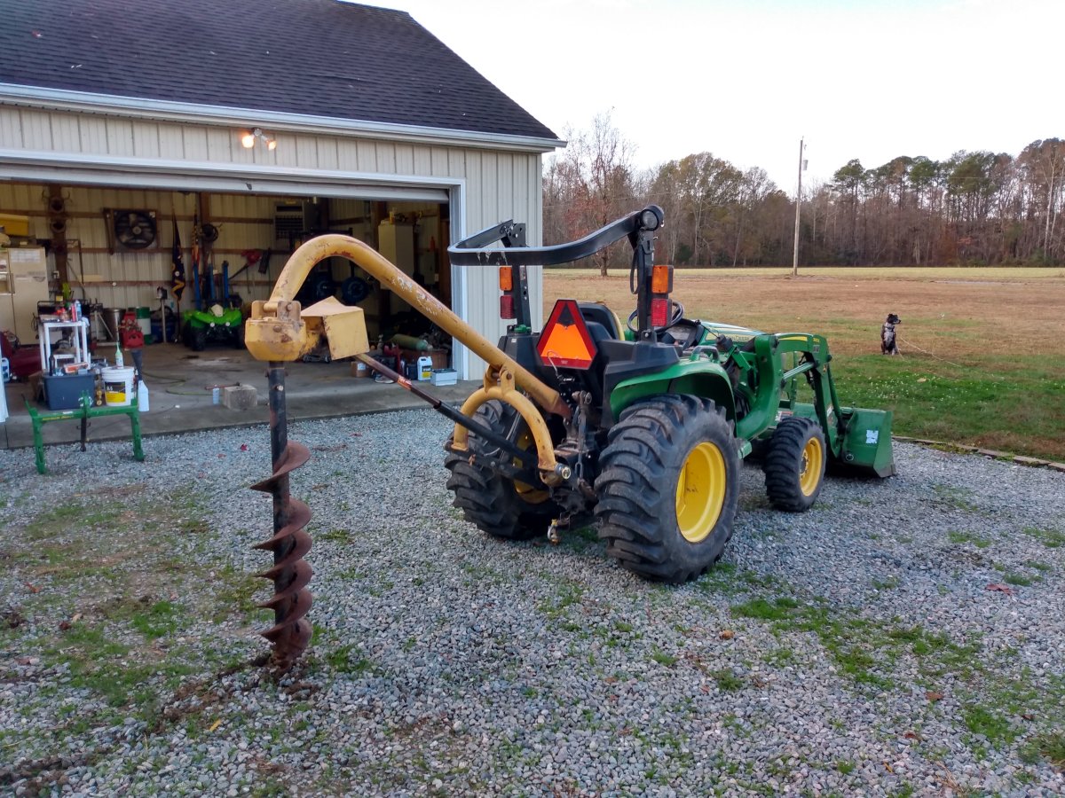

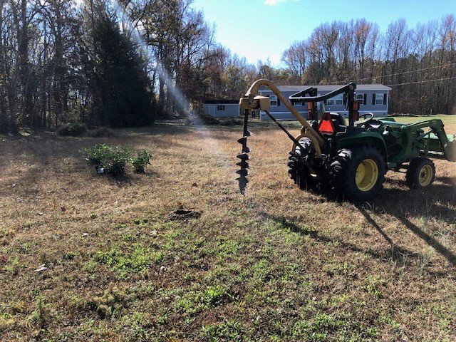

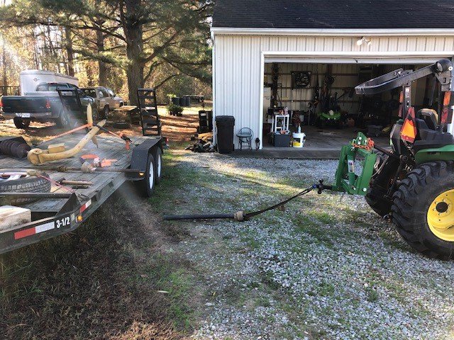

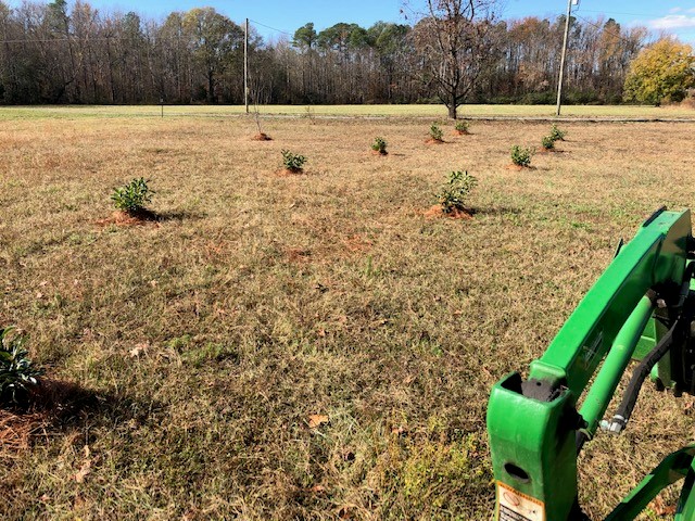

FYI new toy for me over the weekend. Befco used auger traded in at work. Shaft was seized, gear box milky and the coupler on the PTO side was seized. Picked it up for $350 and, had old oil to soak the PTO shaft with after freeing it and had a gallon of gear oil. About 45 minutes of effort it was operational and I was off to plant some evergreens to block the new house put up behind mine from view. Just have to wait a few years for them to grow.
How well do those things tend to work on uneven ground or a slope?
Can't honestly answer that with my experience thus far. I live on flat sandy soil... I put 10-12 holes in the ground to plant some bushes then sank the bit halfway in the ground and disconnected it. I did some work with a hydraulic post driver a few weekends ago with a friend on a 15-20 degree slope hill and it was interesting. That being said mine only has fore/aft articulation of the bit so I am thinking you would have to line the tractor up with the angle you needed if that makes sense. Ideally I would have a second set of hands to guide the but to exact point then engage I was just making rough holes though. Hope that answers your question.
Beats digging by hand by far, but I’m not really sure. We had a family friend run his here for some post holes for a shed and patio with roof, but it was pretty flat where we had him working. Bigger problem was hitting rocks here and some are big enough to park a car on.
